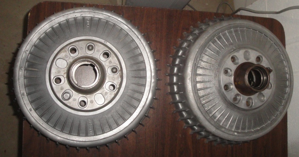

    And I bought this - I think it'll look 'boss' in the '59. I believe this design came out in '64 :   'Dis is the plan :

    Cleaned/painted the bare steel axle ends, re-sprayed one rear drum exterior, put NeverSieze on axle ends and centers of rims, then put the drums & rims back on. As a point of reference : 315/60-

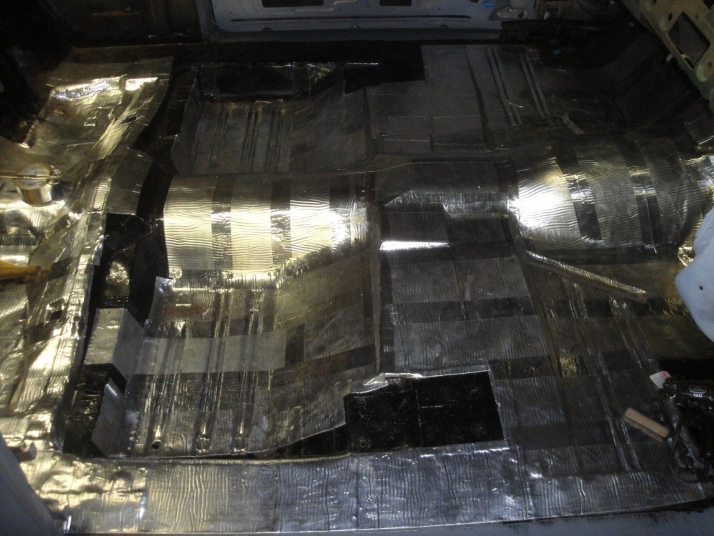

Trunk is finished, metal-wise... tho the pan is square-edged, making laying a mat in there over the contours a bit difficult. I was thinking of spatter-painting it, but that's later, year-wise (for Buick at least). Factory had lots of 'beauty panels' to the sides & back that hid everything but the wheelwells, and my originals are toast and no one makes repros. Don't think they'd fit the new contours, anyway. Still contemplating the trunk cosmetics.
Custom "beauty panels" could be the answer.

This is the official calendar mark - work on the B-59 resumed today, 02-24-18. Handed off the front Al-Fin drums to my buddy to clean up. They were turned years ago, he's going to tend to some brake surface cleanup, paint the hubs, do a tiny bit of modification to allow for aftermarket rims, and clean out the bearing areas.
Spring is around the corner, and it's time to get this road whale (on it's way to) motorvating.
EDIT : 24 hr turnaround, nicely cleaned up. Will clear coat when the weather is warmer.
12" Al-fin (finned aluminum) with iron liners, getting Kevlar shoes when installed.

Have about 85% of the floor inside covered with sound deadening material- a roofing product called Peel & Seal. 6" wide x 25-ft, you cut it to the desired shape, heat it up with a heat gun, peel the paper backing & roll it down. It's some sort of butyl rubber / asphalt with a heavy foil on the upper side. Then all the seams were gone over with aluminum tape. This makes the car both quieter and cooler inside. Power level/ air volume is likely going to be making some heat under the floor, and I'm already a bit worried that any decent performance mufflers are just going to be too loud IMO.
Need to SOMEHOW come to a decision on rear speakers, since there are NO cutouts in the rear window area for any and it's time to cut them. However, I really have never paid any attention to car sound systems; I'm clueless here. I do have a friend who used to compete in sound competitions, I think he was once clocked at something like 143 db. Hopefully he can 'dumb down' a recommendation for those who don't care to bleed from the ears when they listen to music.
