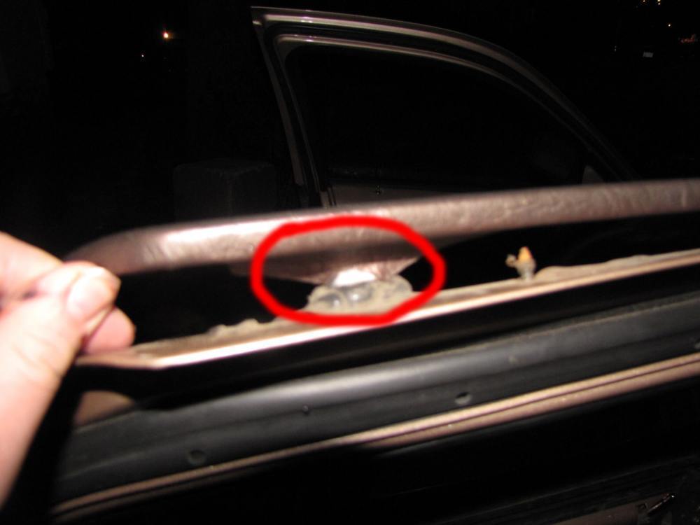

Problem is that the car has one of those landau tops, and the part that goes on the door goes over the stupid window frame. There's no way to get the glass out or in with it there. My question is, what adhesive do they use the secure the tops? It looks kind of like rubber glue. I see no other way than to cut the adhesive off so I can pull the thing back enough to fit a window in. I'll need to reattach with new adhesive afterward.

BTW, adhesive used is likely 3M 77.

The attached file is shpws the adhesive that was used (in the circled area). It rubbery and black.

X2 on the 3M adhesive.
Rubbery and black (although it looks tan in the pic) sounds like it could have been a weatherstrip adhesive or that 3M "trim and emblem adhesive."
Oh, I didn't think that was the adhesive you were referring to... yeah, that is likely just general weathership adhesive. I thought you were referring to the adhesive holding the vinyl to the 'cap' that is actually attached to the door.
