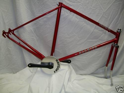

It's a project nonetheless.
It's a late 70s/early 80s Schwinn Traveler that I saved from being trashed as a single speed/fixed gear bike. At the time, the Traveler was Schwinn's middle-of-the-road bike. I'll try as best I can to bring it back to what it looked like when it was first built. The frame and the finish looks to be in great shape - worth the $30 in my opinion since older Schwinns in any condition are increasing in value. I have an old Royce Union road bike that's got a bent rear frame that I can't straighten for the life of me (even though I was the one who bent it, somewhat intentionally). The rear tire doesn't align properly and the bike pulls to the right slightly. Basically I'll be transferring the wheels and most of the components from the Royce Union to the Schwinn. I'll also be taking the crankset off and replacing it with one that has two chainrings.

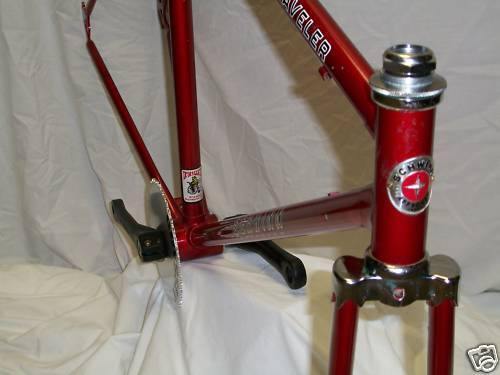

I also found out some more info about the frame itself. It was made in (ugh) Japan by Panasonic for Schwinn. According to the date code on the badge on the head tube, it was made on May 19th, 1976.
