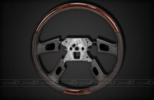

One "luxury" feature of modern vehicles I like is the leather and wood steering wheel. The Envoy SLT model never offered it, but the Envoy Denali came standard with one (pictured above). The "wood" on the wheel matches the "wood" on my dash, so I think it would be a great item for me to enjoy. Of course I don't have the tools needed, so either I would have to find someone that does or take it to a shop/dealer to have it done. Anyone have an idea of how difficult this is, or how expensive it would be if done by a professional? There's three "salvage yards" near me with modern iron, so that is where I would start my search (of course eBay has them between $99-$249, but I think it will be cheaper finding one in a local salvage yard). I don't want the airbag - mine's fine - and the steering wheel cover can stay too (I don't want the Denali cap, I'm happy with my GMC one).

Here's a wheel on eBay... basically, this is the standard wheel like I already have but they added wood trim to it. I want the factory issued wheel with the chrome trim rings, but this is what I want to find in a salvage yard (what is pictured).
Swapping the wheels isn't too hard... you just need a steering wheel puller... $10-$15 at your local Parts place. Disconnect the airbag safety wire under the dash (bright yellow). Typically, you'll have a few screws (Torx (on new ones) or phillips) in the back that hold the airbag/cover. Under that, there is a big nut. Remove that. Mark the position of the wheel and shaft. Put the puller on, crank it a few times, and it comes right off. Use the big nut to push the wheel back on.
On a good day, its a 10 minute routine.
I'm assuming here that the two wheels are sharing typical GM parts bin parts... I.E., the same steering wheel controls, etc.
Also, if you buy the wheel from a junkyard, I've found that a lot of junkyards are a PITA about separating the wheel and airbag, since some are kind of a matched set... the airbag and cover are packaged together... but having a spare airbag (granted, one with the wrong emblem) can be a bonus later.

Wheels I've pulled have usually had a keyway, so they can only be installed degreed one way.
