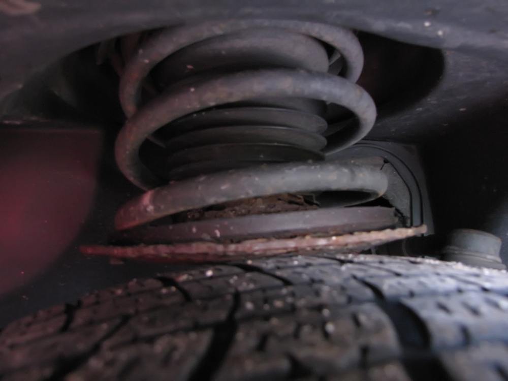

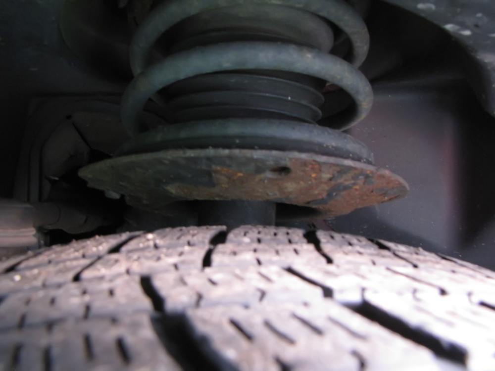

It's none of those, the hub is actually fine. Brakes make some noise but that's just because the rotors are slightly warped. New pads and turned rotors were in order, but it turns out the problem is quite worse actually. I think a visual aid is in order.
This is the driver's side:
and this is the passenger side (the one making the noise):
What we have here is the spring seat on the strut has rotted through and partially collapsed, the noise has been coming from the tire rubbing on it. I should count myself lucky it hasn't given out. Needless to say its going nowhere until I can get together the money for two front quick struts (might as well do both), OEM mounts and poly isolators (might as well do them right).

Ouch, that's ugly.
I suppose if you were really needed to use the car, you could compress the spring slightly and put a couple big muffler clamps on the strut to hold the spring seat off the tire. You know, emergency stuff.
