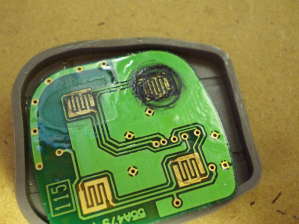

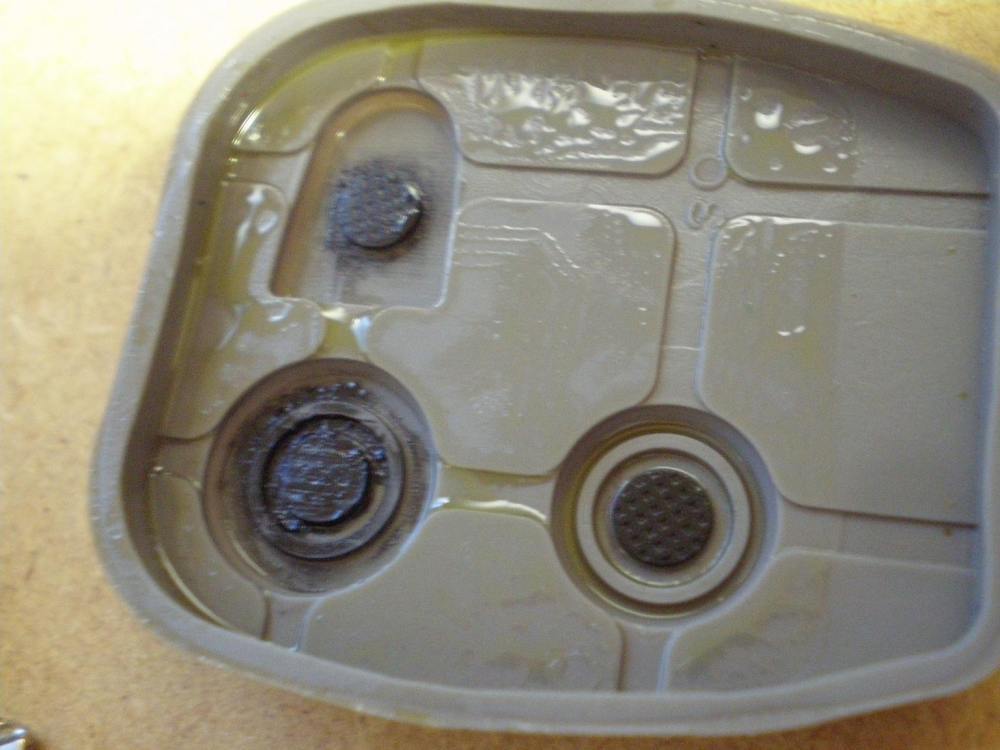

As for your FOB, its likely dying. The transmitters seem to get duller as it ages, and you end up replacing batteries more often to compensate. Perhaps open it up and clean all the contacts.

oh. and cleaned the FOB up with rubbing alcohol. still works, but only tried to unlock and lock once. no trouble.
