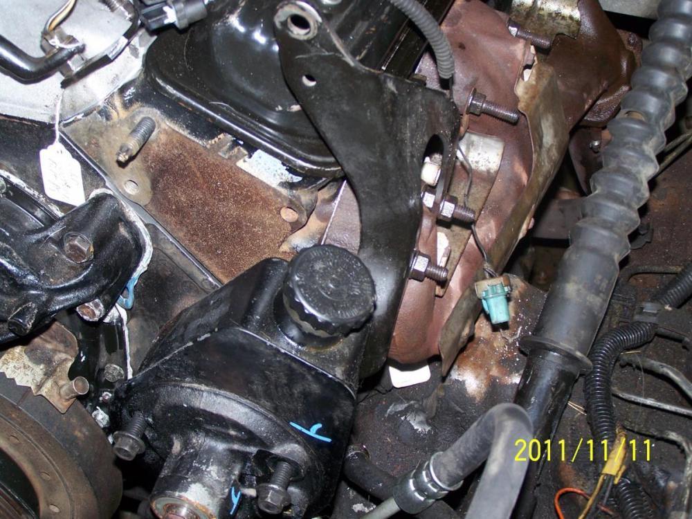

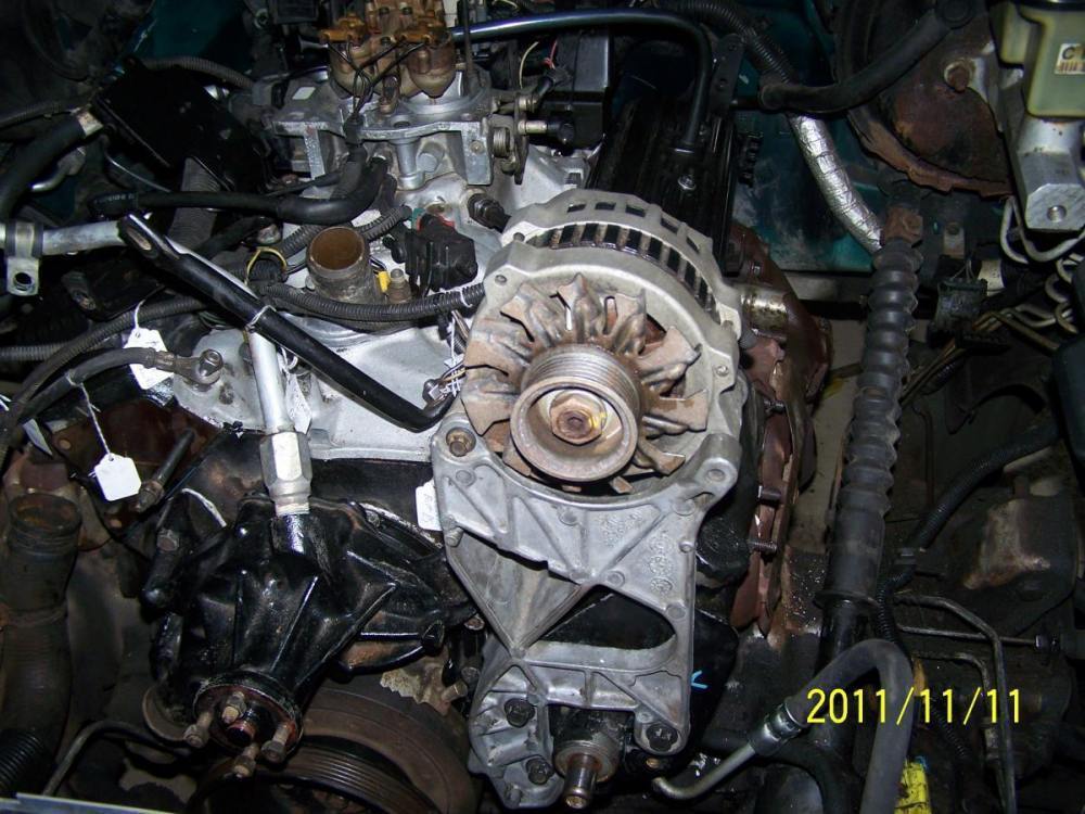

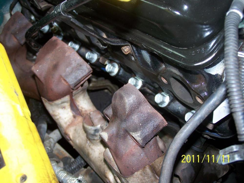

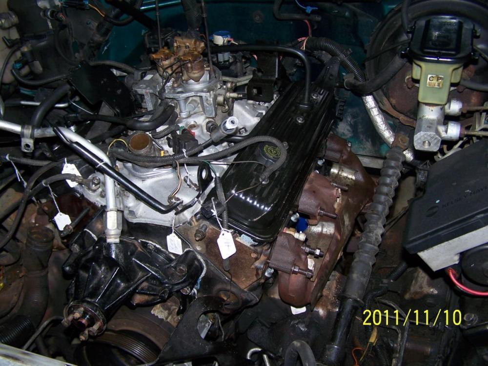

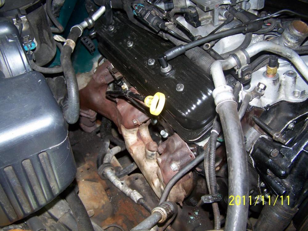

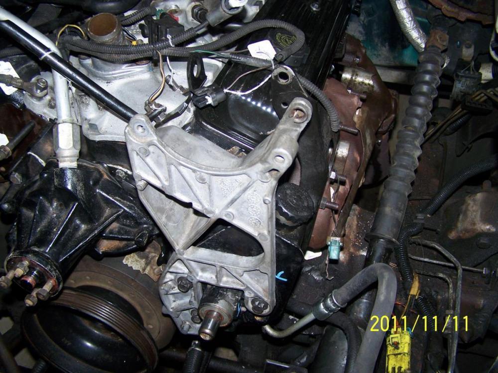

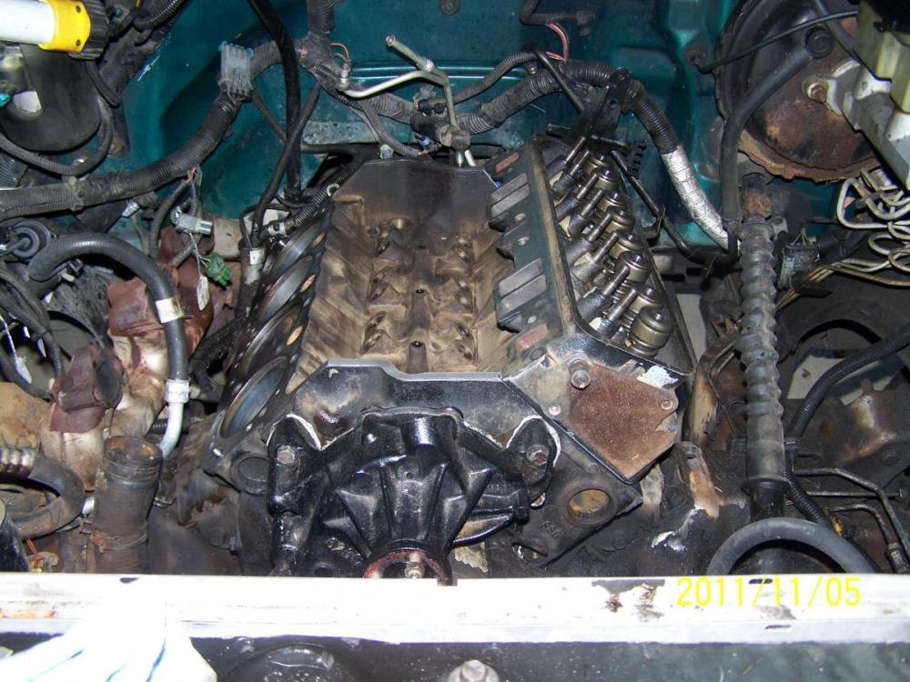

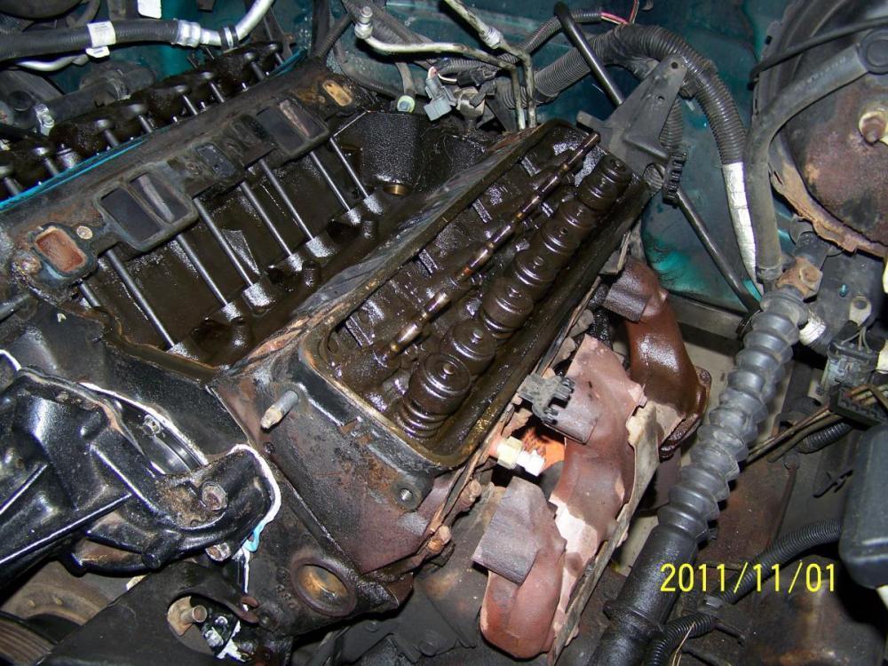

Heads are about ready to come off, but I'm just too beat. The exhaust manifolds where much easier than I expected, and interestingly, the most rearward bolt on both sides was simply absent. Those two would have been the toughest to remove, but I wonder why they weren't there, and why I had no exhaust leaks. The other cool thing is that once I remove the dipstick tube, I can slide the whole exhaust rearward and out of my way. I have already pulled the rockers and pushrods from the driver's side head but I stopped so that I can get a shot as is to show you guys tomorrow. Given about an hour, both heads should be on the deck.
My biggest worry at the moment is being able to actually lift them out of the engine bay - the physics are all wrong. Trying to pull such heavy pieces out of what amounts to a deep hole should be an experience.

When I had the engine out of the SS454 P/U I was working on I did most of the lifting with the hood off & radiator out,standing on the sway bar. But you don't have that option right now.

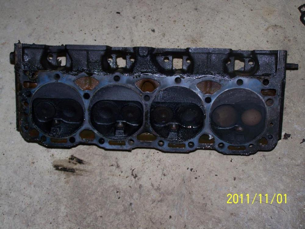

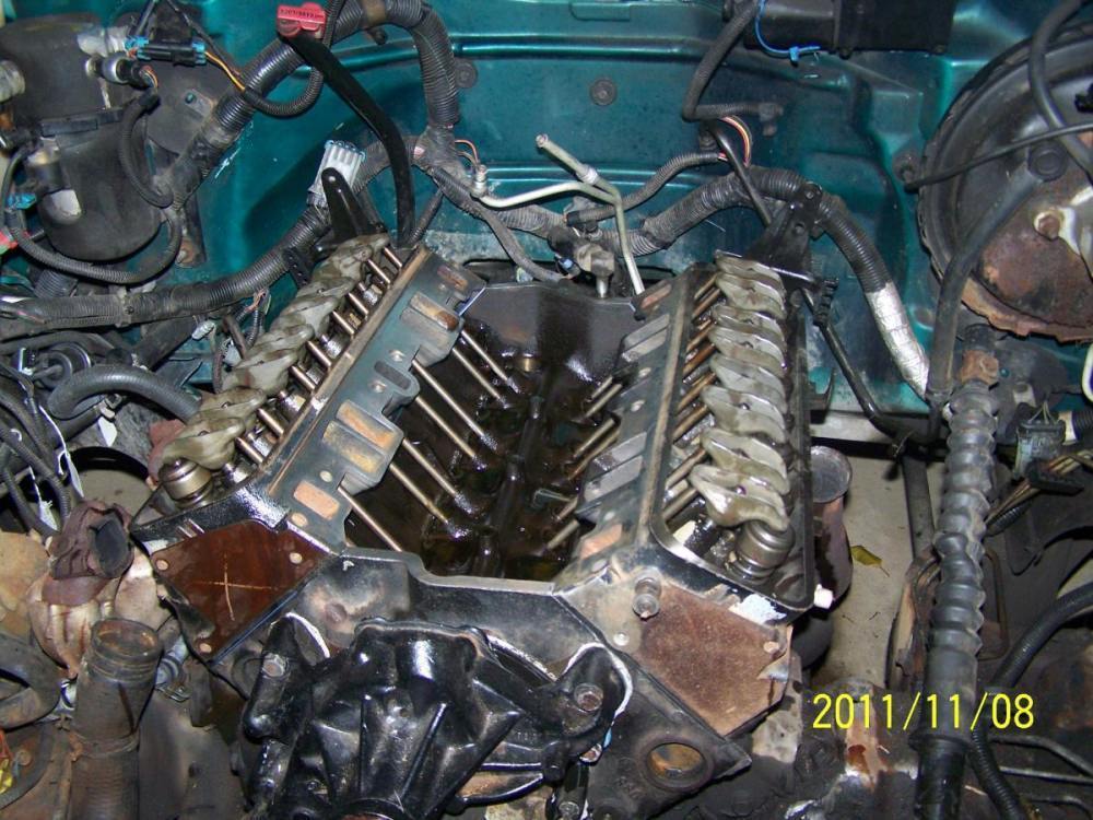

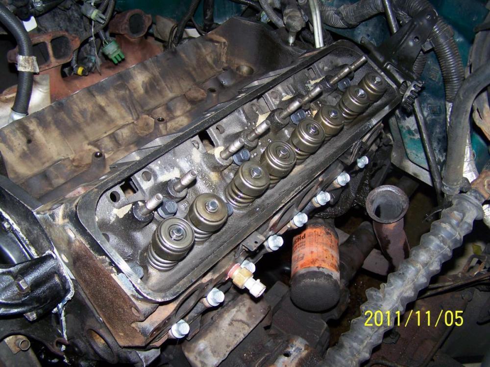

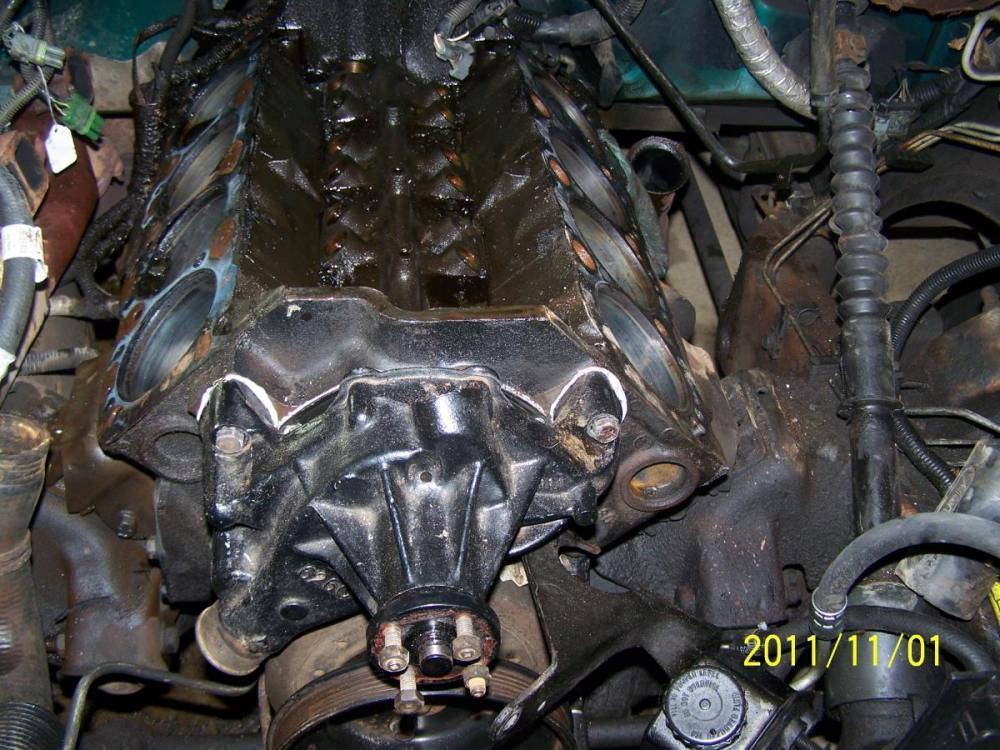

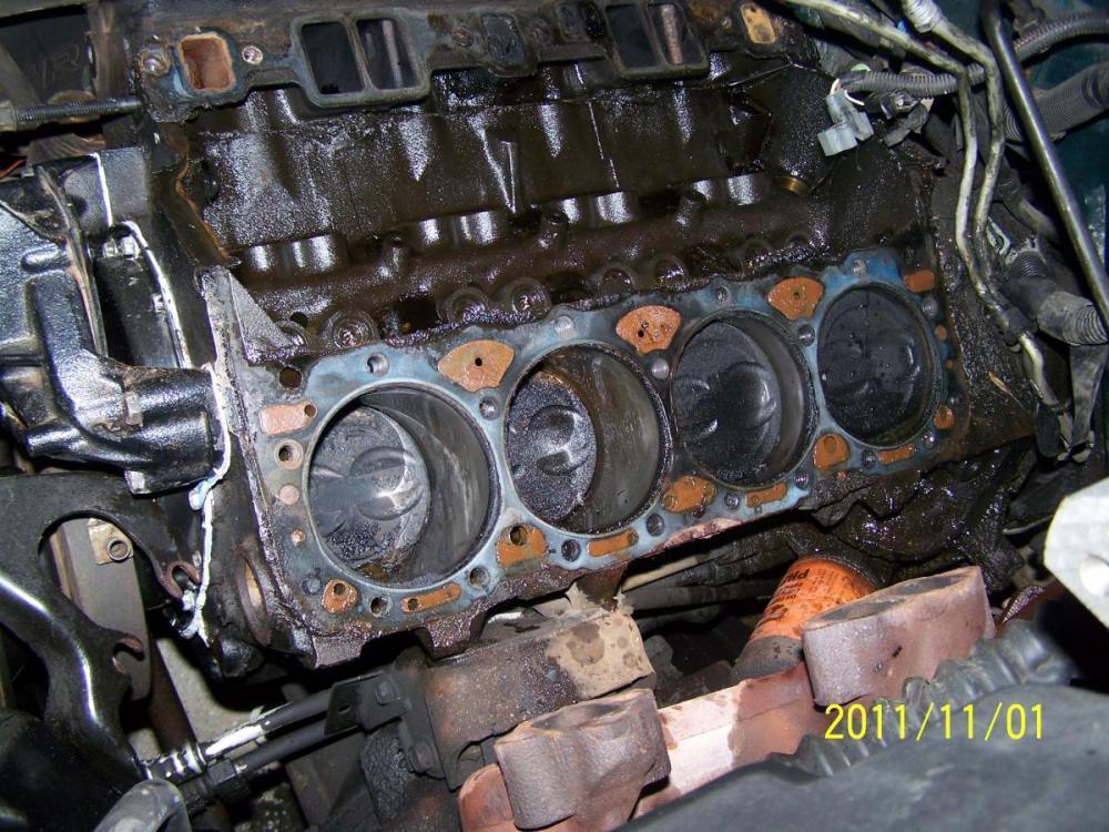

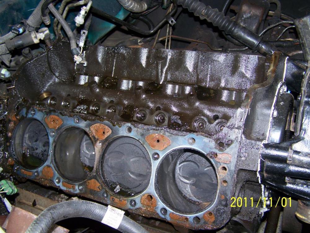

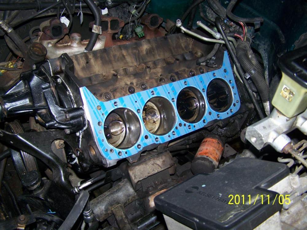

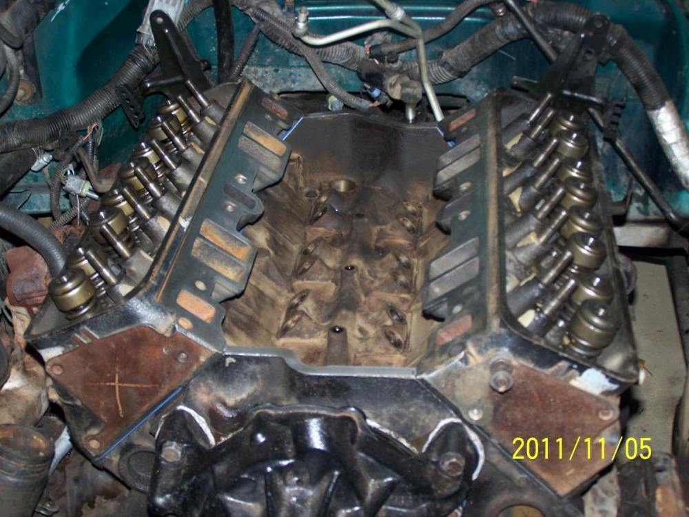

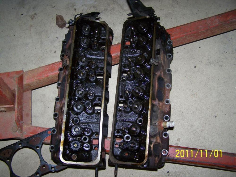

I was going to wait until both heads were off to post these, but since the site will be down tonight I'll do it now. I ended up having to remove the driver's side exhaust manifold after all. And the Driver's side head gave me an unexpected fight. The head bolts were really, really, tight - as if someone overtightened them to hide a head gasket leak? Who knows, but the previous owner was a real tool so it could be. At any rate, here are some pics:
It might be just a shadow but the darkness between Cyl's 3 & 5 makes me think you should check both block & head for parallel one or both may be warped. Good news is that blocks rarely warp but I've seen my share in my 4.5 years machining and 35 years wrenching. Those two pistons look like they've not been firing also could've been the popping and miss
I think that's a good bet, I also think coolant was making its way into several of the cylinders on this side. If the block is warped, I'm going to find out the hard way. As for the heads, they will either be replaced or re-done.

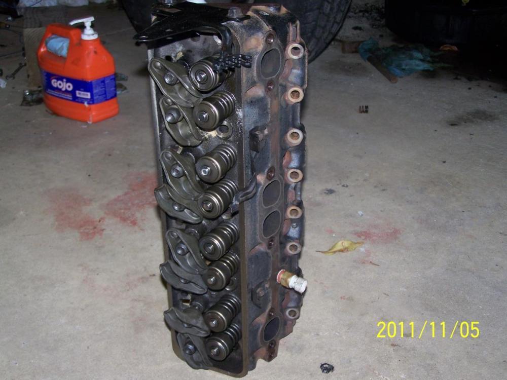

Picked-up a set of very low-mileage heads last night, Now it is just clean and re-assemble, clean and re-assemble...

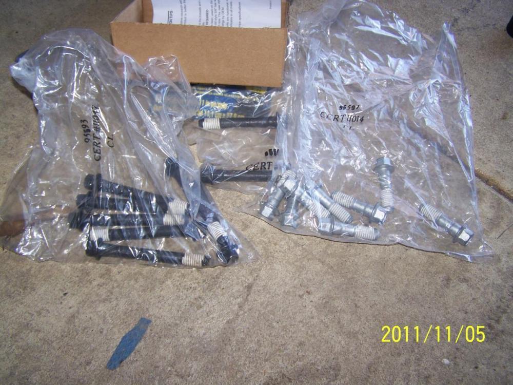

They aren't torqued-down yet, but it's nice to see them in place. The new head bolts were a good call - they come pre-coated with sealant. A friend from Maine is in town, so this is where it stops for today.
Pics:
I completely forget what vintage the Tahoe is, except that its sometime in the '90s... so if its towards the end of the '90s, I'd say new head bolts are a good idea, as GM started using those Torque-to-Yield ones... but I completely forget when that started.

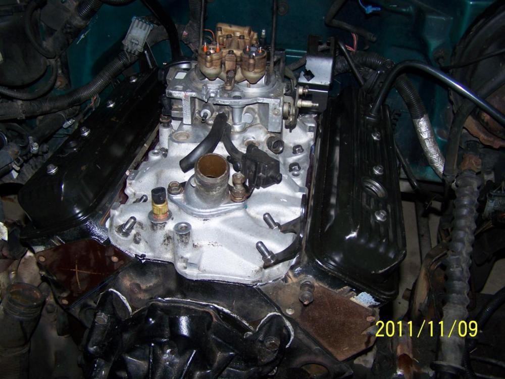

Heads are torqued, valvetrain is installed and adjusted, intake going back on soon.

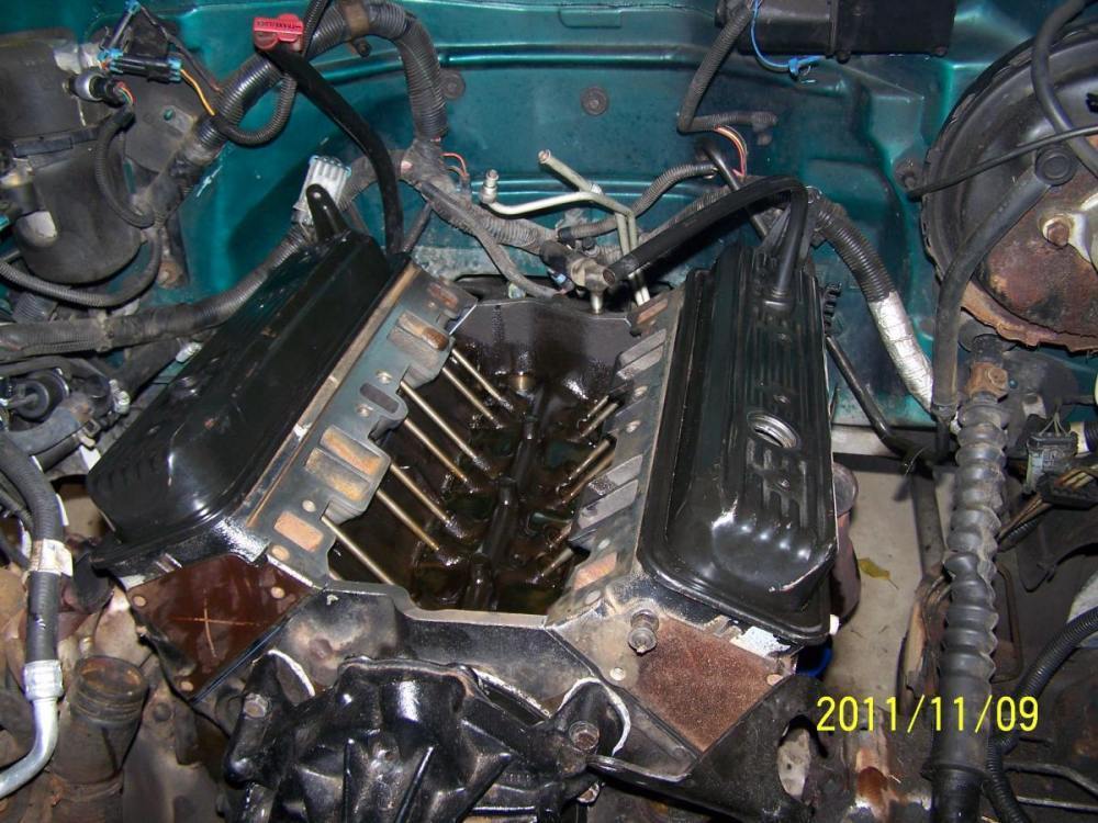

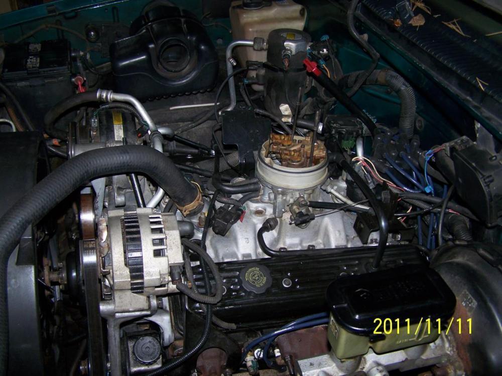

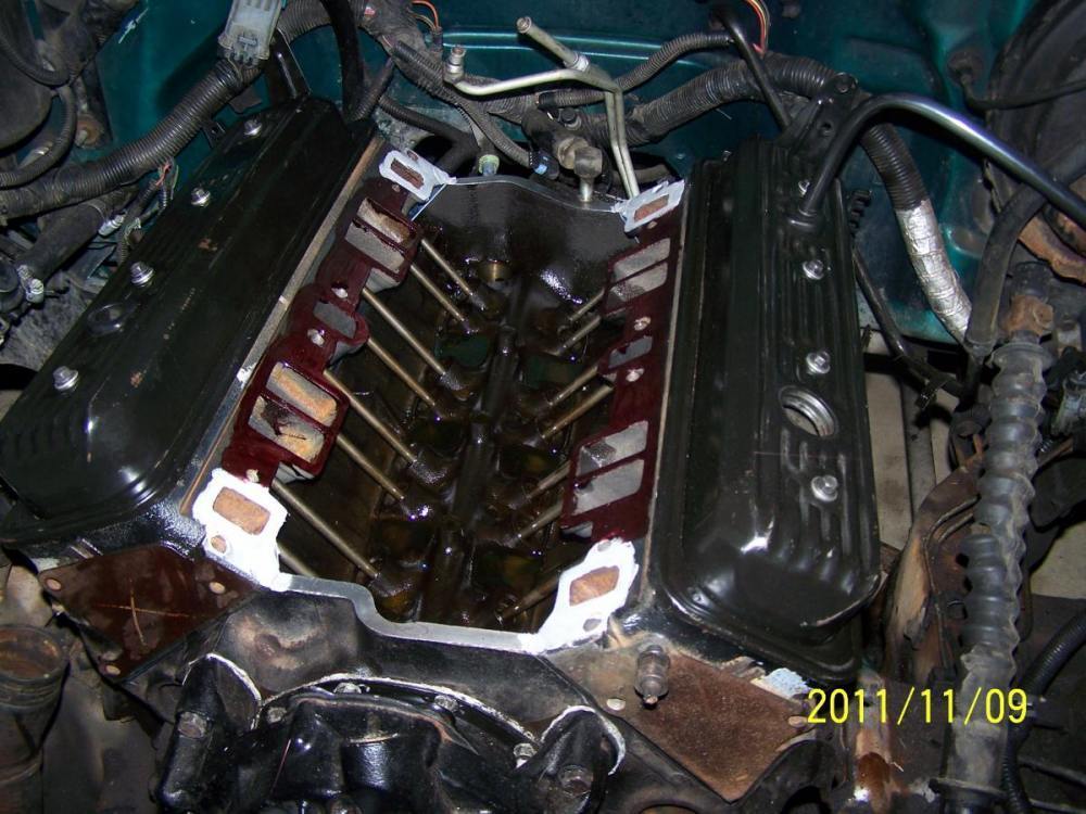

Here are some pics that actually look like an engine:
You've invested a lot of sweat and time into this. Soon you'll be back on the road and up to speed once again, sir.

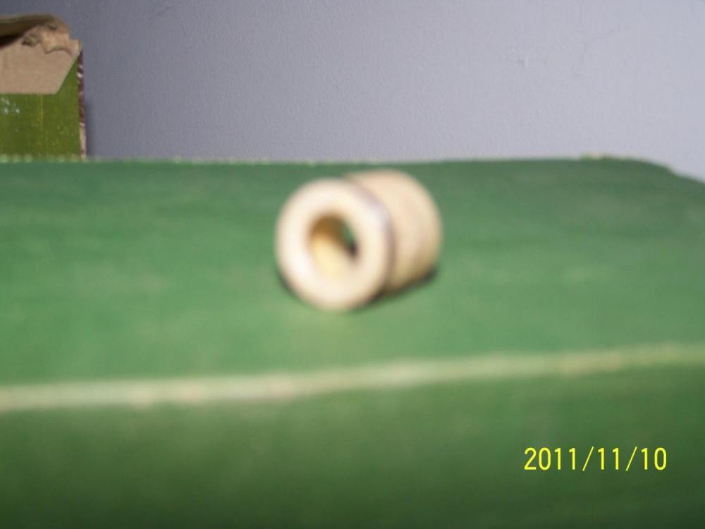

OK, that has to come out.
But just how in the hell am I going to accomplish that? That thing is way down deep inside the newly-assembled engine. After trying to catch it with a long screwdriver, and failing, I devised a new method. I clipped off a piece of electric fence wire at about 2' in length and created a hook at the end. Then, with my face against the firewall, my knees on the engine, and my butt in the air, I grabbed the panlight with my left hand, and the wire with my right and somehow managed to snag the offending part. Holding my breath, I then carefully extracted it straight up and out of the engine. I could easily have fallen-off and into the lifter valley where it would be unreachable without pulling the intake all over again - but I got lucky.
Whew!
So then the mystery of what the hell this thing was, and what (if anything) it did as part of my engine, became my new concern. I sure didn't want to open the engine up again, but if this was a critical part I didn't know about, I wanted to get it to where it belonged. It didn't look like anything I'd ever seen inside a Chevy V8, but I needed to be sure. So I jumped into the wagon, and paid a visit to the local Chevy dealer. No one could positively identify that little, white,PITA. But both the mechanic and a group of parts guys agreed with me that it didn't belong anywhere near where I had found it. Good enough for me. What a bizarre sidetrack this has been for my project. I still don't know what the thing is (our collective best guess is a valve seal), but it seems it was just some automotive flotsam a careless mechanic allowed to drop into the engine at sometime in the past.

That mystery part reminds me of an old ceramic insulator from a power line..
Yeah, it looked the same to me. At first, I thought it might be a piece of broken spark plug insulator, where the insulator snapped off cleanly and was not bonded to the core. But plugs typically do not break that way, and I'm sure Camino would know ceramic from plastic.
It that a o-ring or just black paint. It tough to get a sense of scale on the part, but it's nothing I can identify as an engine part or even a GM part from the '90s.

The part does indeed have a tiny o-ring, and it is about 3/4" long overall, with a diameter of about 1/2".
I thought about the "sticky" approach to getting it out (I have some butyl tape onhand).
Camino take a look at all fuel line fittings that looked like a valve seal but should have been black for that. The fuel line seals on that 454ss I did looked suspiciously like that item
The only fuel line fittings I've seen on the Tahoe are the two at the throttle body, and they are just o-rings on metal - no plastic.

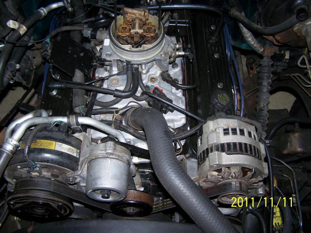

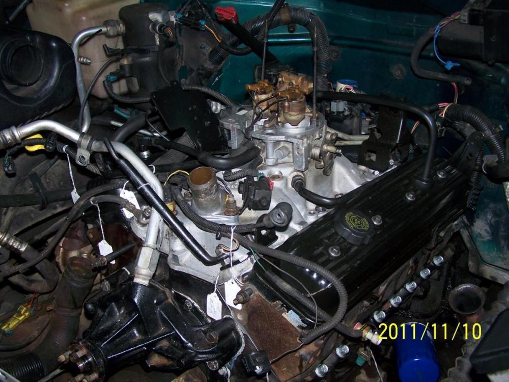

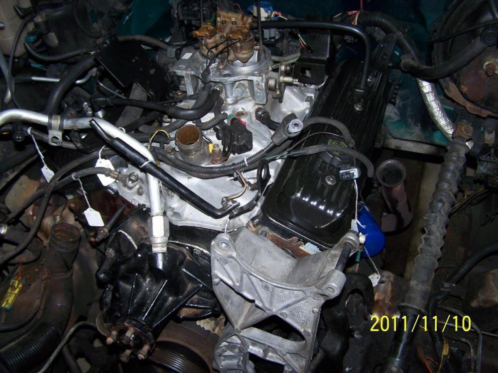

It's all back together!
I don't yet know if it will run for me as the battery was just too dead from sitting, and I'm too tired to wait for it to charge. I expect to have to fiddle with the timing, and maybe take the computer out of the loop while I'm doing it. Tomorrow's another day.

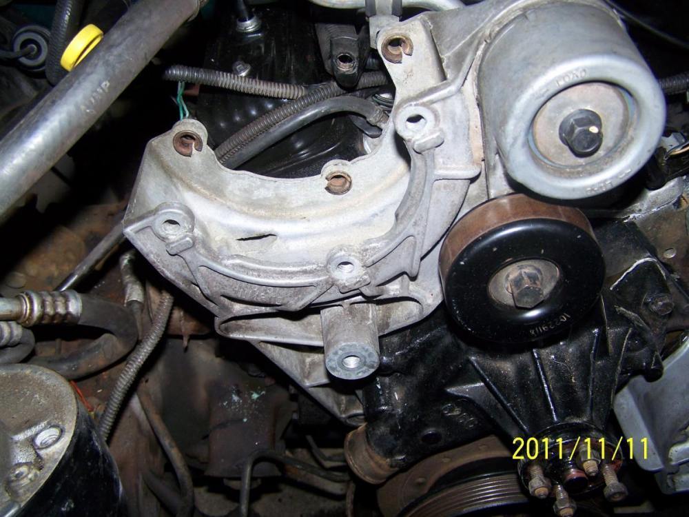

Here are the pics from tonight:
No joy yet - spins beautifully, but refuses to start.
Been through all of the preliminaries, and am all but certain that the old lifters have made the valve adjustment moot. Working from that premise now.
