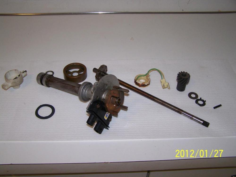

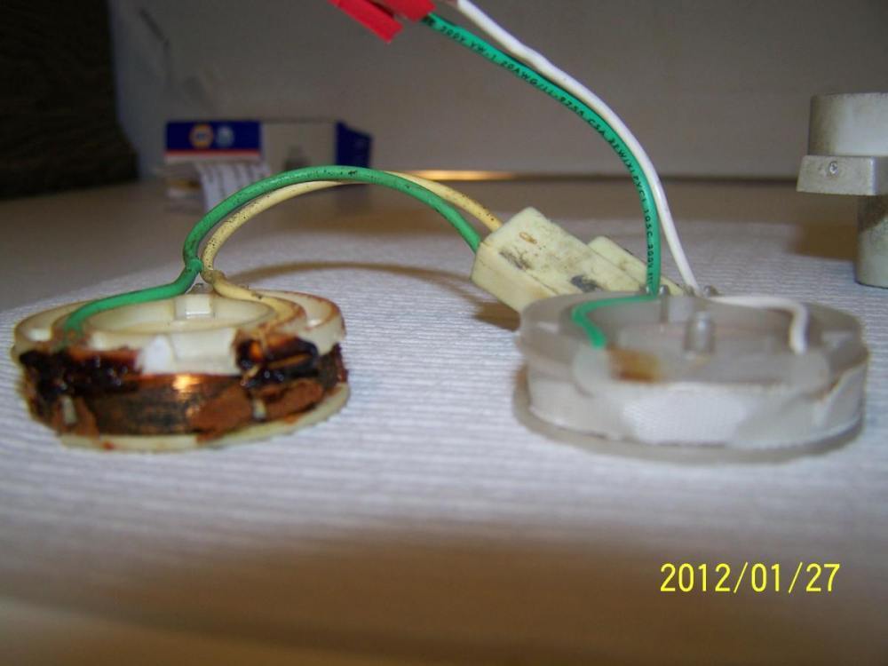

Okay, here are some pics of the distributor in a disassembled state. An overall shot of the parts involved, a shot of the old and the new pickup coils, and a shot of the reluctor (GM calls it a bse plate or something like that) showing the rust and the crack. This combination was the source of much of my trouble at the end of the project - and a large part of the problem before I started the top end job.

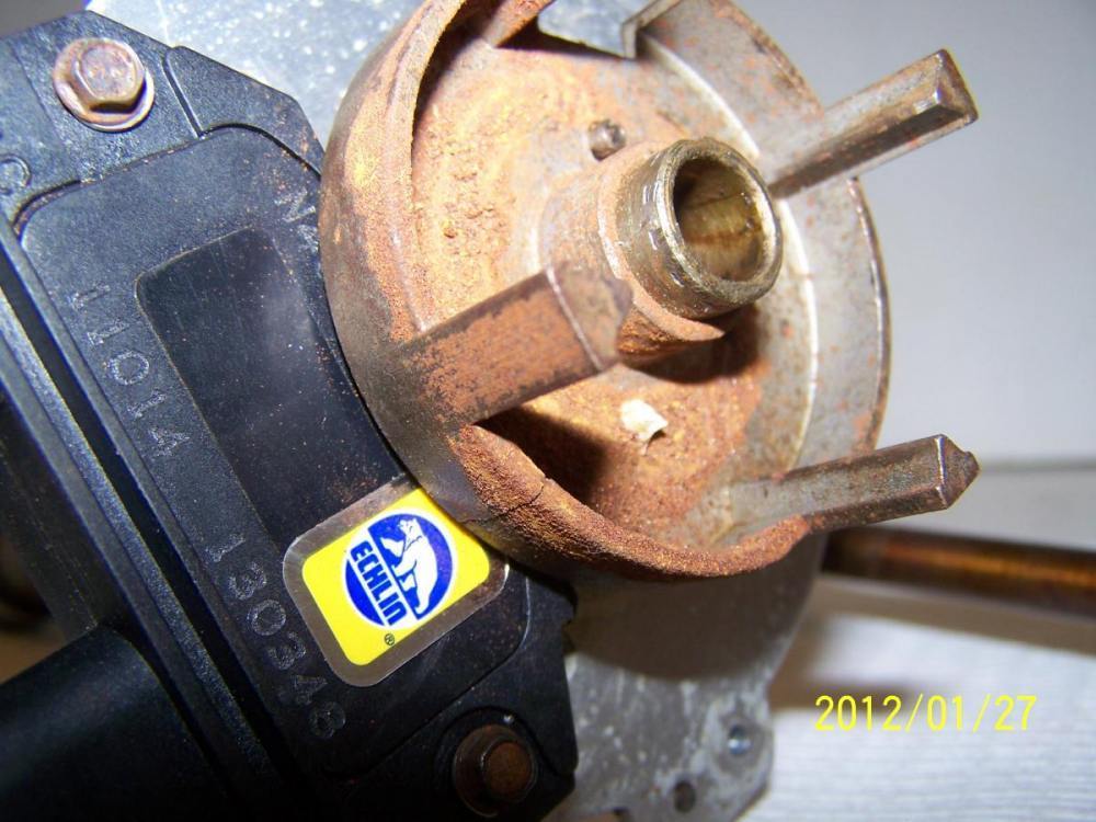

Got the new "pole base" (as GM calls it), but now I've found another bad part. The "disc" that is pressed onto the long shaft you see in the pictures is a magnet, and is cracked at one of the points. I'm off to order the part now.
Pics when I get back to this.
I'll bet that was the original problem with the multiple misfires Camino
Yup. Two cracked components in the distributor will certainly do it.
Now I'm fighting to get a reasonable price on the part I need - GM is insane sometimes when they price stuff. I can buy the whole distributor for the price of the damned shaft with the magnet.

Here's a shot of the new "pole base" (quite reasonable at under $20). I also tried to get a shot of the crack in the magnet of the main shaft, but it refused to focus. I'll update when the new shaft arrives.
Rebuilt the Tahoe distributor today. I think I'll put it back where it came from and let Mothertruck have its own distributor back.
Pics:
Wow, I love learning new things every day. I always just replaced the whole thing, never knew you could buy a rebuild kit for the distributor.
Well, it wasn't a kit. I just discovered more bad parts as I went along and ended-up rebuilding the whole thing.
If I had known so many parts were shot, I'd have bought a new one to begin with.
I probably should have rebuilt mine... but I bought a cheap new one, and it has had several problems that have sidelined me. But I just didn't see a good way to reindex the unit without a lot of special effort. (It was burning out caps due to the Hall effect part being out of wack with the pointer.)

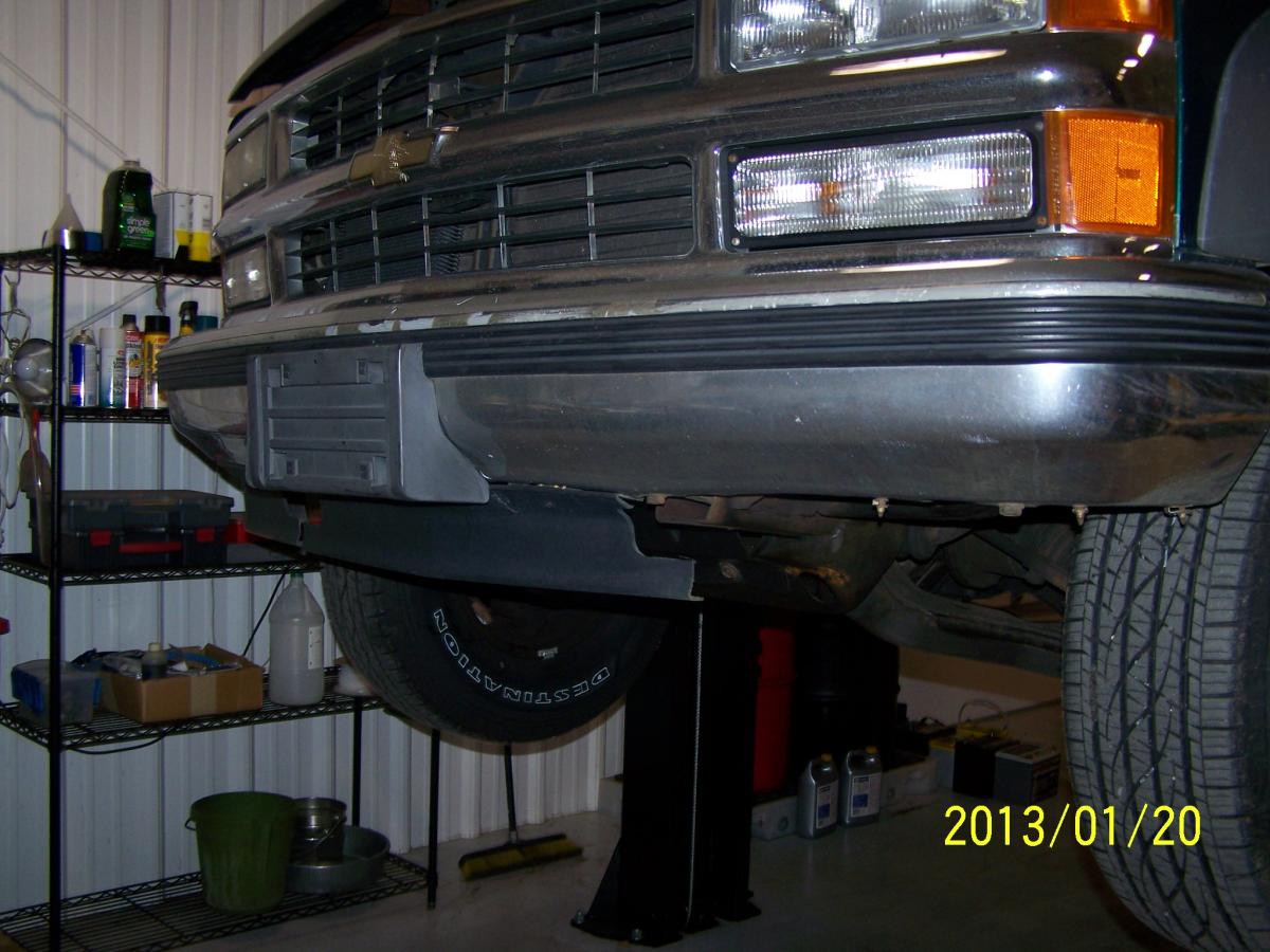

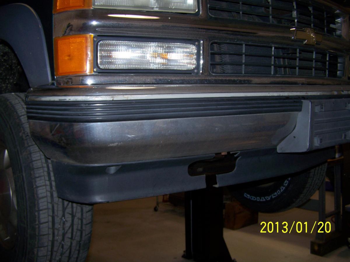

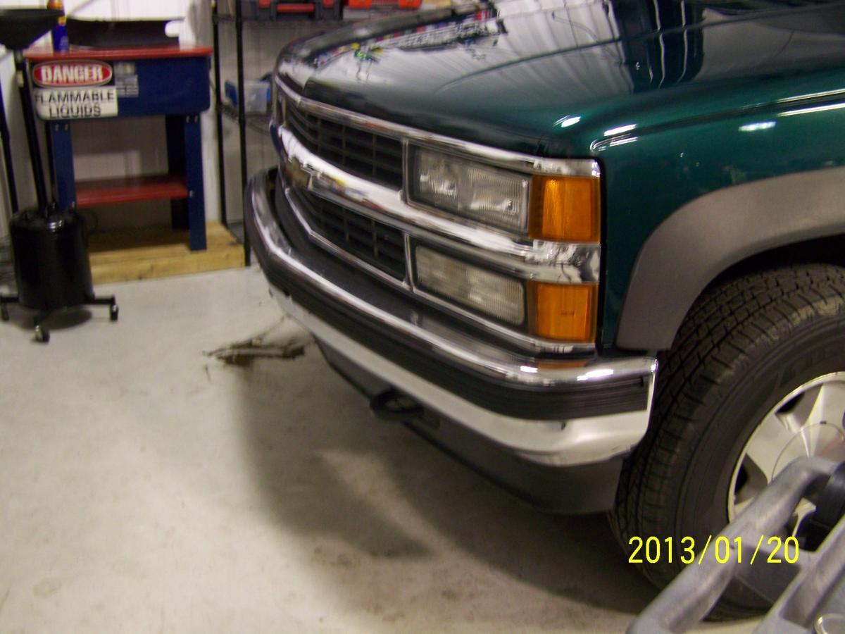

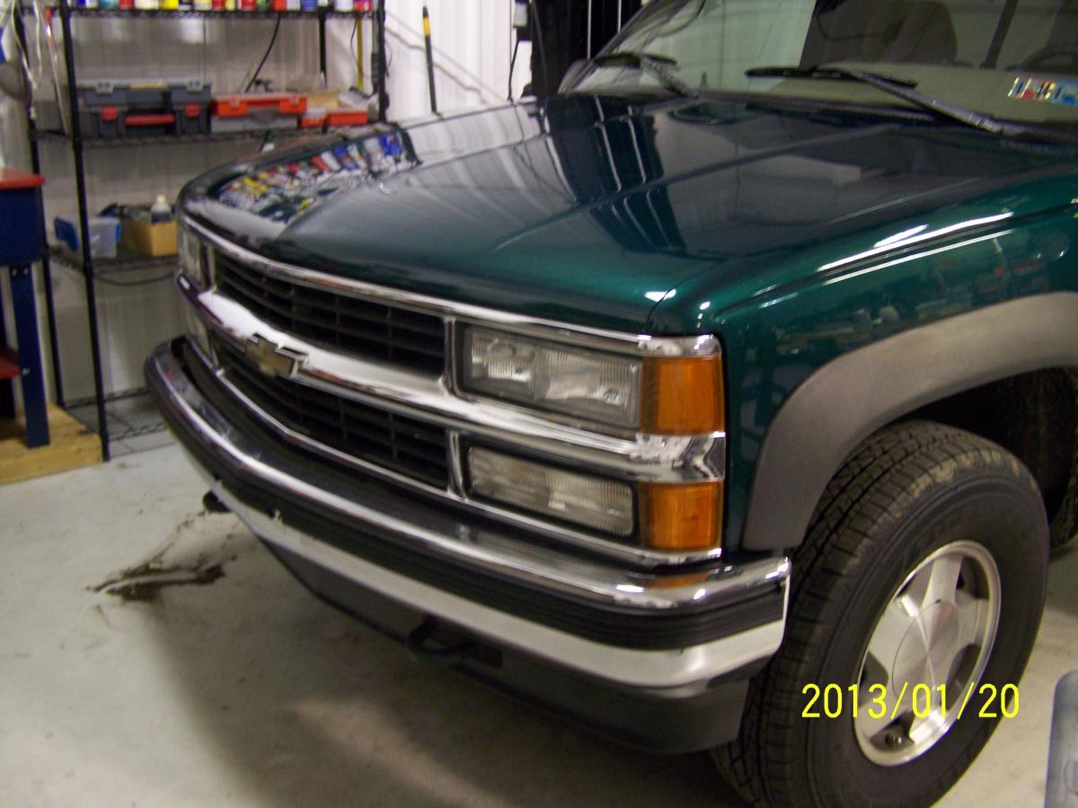

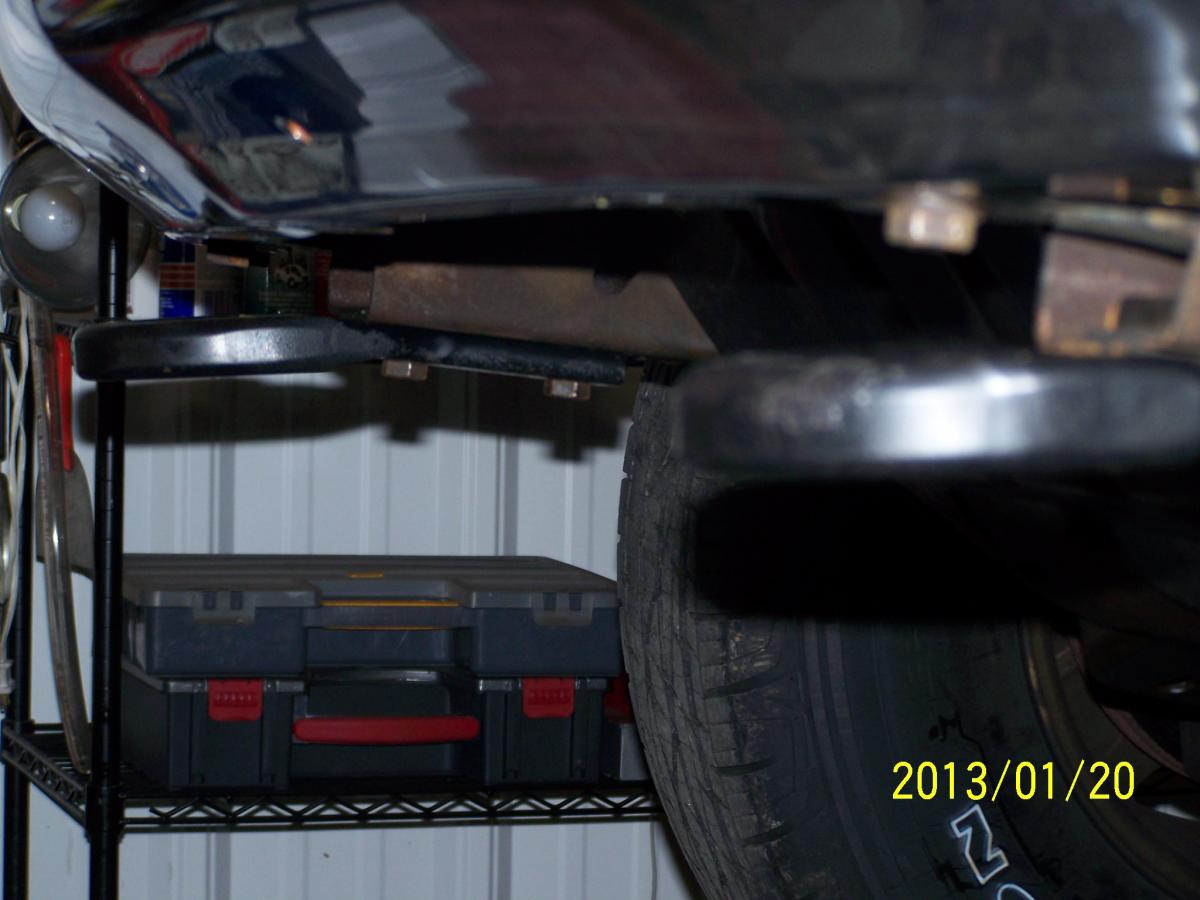

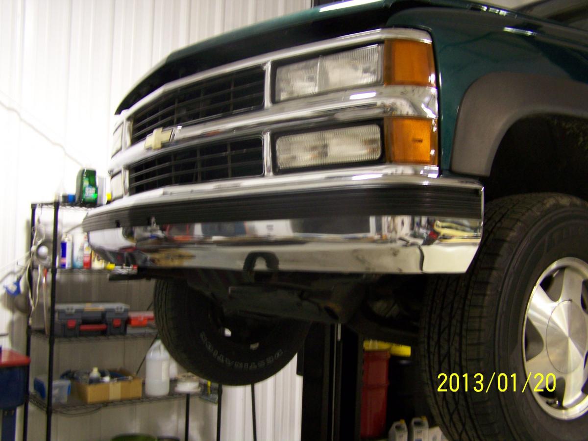

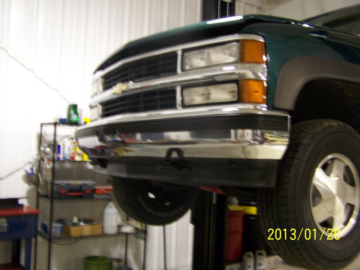

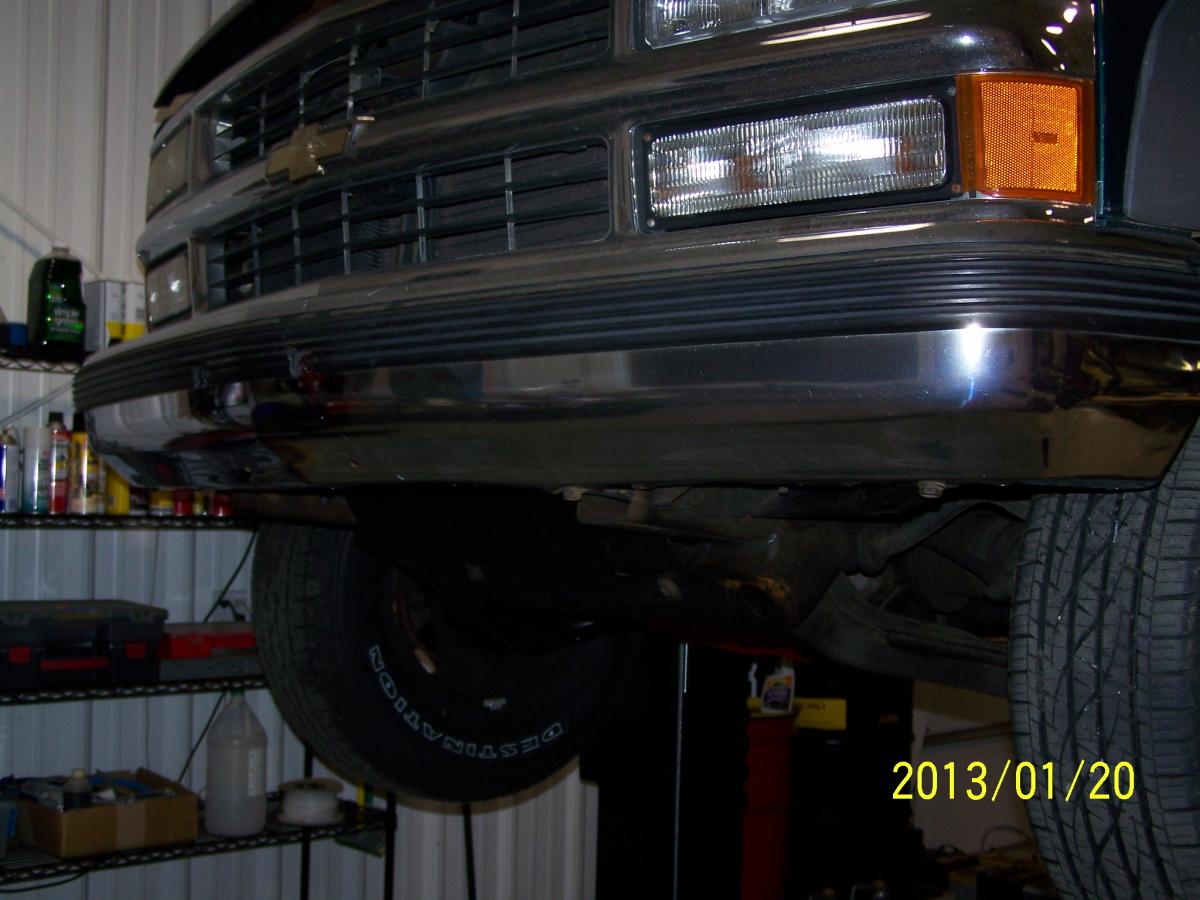

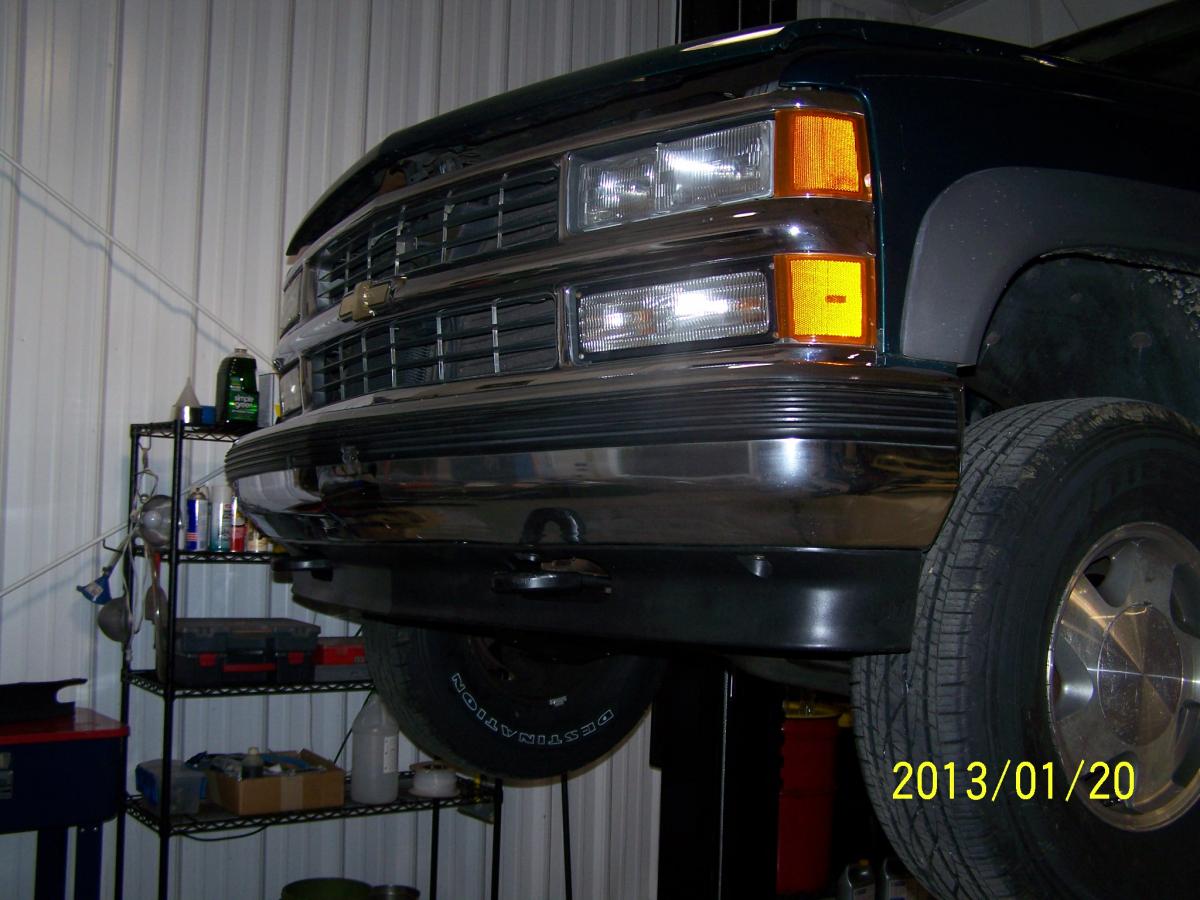

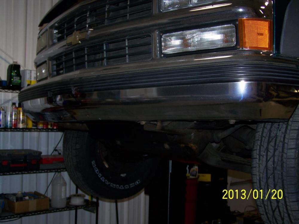

Took Green down to the race car shop tonight and put it up on the lift.
First I did an oil change and then moved on to my punchlist.

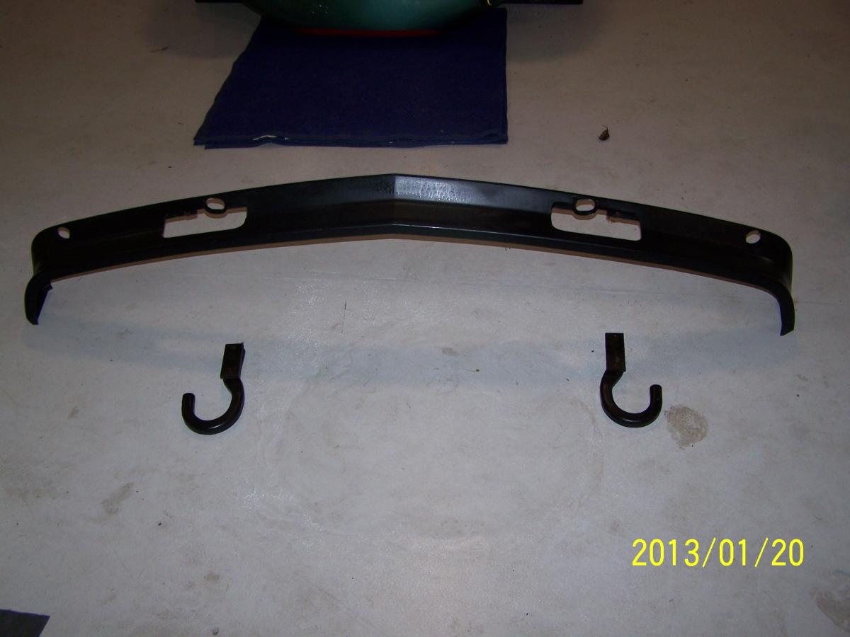

This Tahoe once had some sort of pushbar on the front , and some previous owner cut the chin spoiler to install it leaving it in three sections. One of those sections has been MIA for some time now, leaving the front of the truck looking a bit dopey. The front tow hooks were also missing when I bought it.
Lucky for me, These exact parts had to be removed from Red to install the snowplow.
So I removed the old pieces of spoiler, yanked the ugly license plate mount, and removed the "chrome" trim piece from the bumper rub strip.
Then, I installed the two tow hooks, and gave the bumper a quick clean and polish.
The bumper has a minor kink in it, and I had to persuade it to flatten out at the bottom edge so that the spoiler could mount flush. That took some time and effort, but I got it to cooperate enough to mount -up the spoiler. I think Green looks much better up front now.
I forgot to get a shot of the completed door hinges, I'll do that next time.
EDIT: You can also see the spanky-new tires in these shots.
Edited by Camino LS6

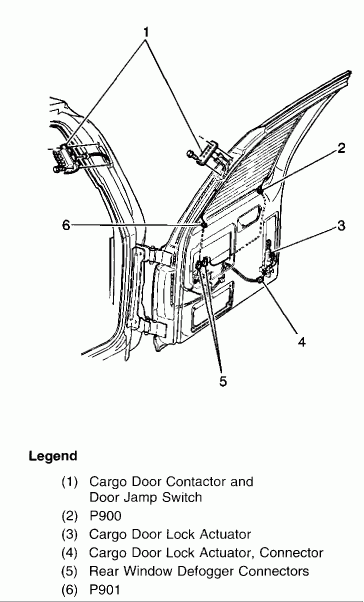

I also may have conquered a long-term problem with the interior lights. From the time I got the green Tahoe, I have had to use the dome override switch to make the interior lights go out. About a week ago, I got a new door switch for the driver's side and that seemed to fix it for about a day. I was annoyed, but not all that surprised, that the problem came back. So I did a little process of elimination and determined that the barn doors seemed to be where the trouble was. So, tonight I also cleaned the contacts on both barn doors, and dabbed a bit of grease on all of the connections. So far, that seems to have done the trick.
Well, the interior light thing isn't completely over. They still stay on sometimes, but a slam of the cargo door shuts them off.
I may attempt an adjustment of the pin-type contact switches on the cargo doors. I've looked for replacement switches, but had no luck - not even sure what GM calls them.
Here is what GM shows for the Back Door Electrical connections and yes, as they wear out, they will cause electrical disruptions.
Order a Cargo Door Contactor and door Jam Switch.
JC Whitney has two or 4 node universal contact switches
