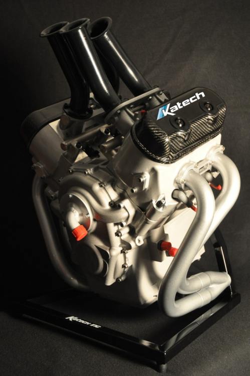

GM would not have to invest Billions to Create the V4, one of their licensed Corvette Racing and engine builders have already done the work and has a Solution GM needs to pick up and use.
http://www.katechengines.com/engineering/katech-v4/
If you have Driven a Motus Motorcycle which comes with the Katech V4 engine based on chopping a Corvette V8 in half you would be amazed at how silky smooth and powerful this engine is.
Katech sells a Crate version of the V4 for anyone with almost 400HP/lbs. It really is an amazing engine that is not turbo or supercharged. Proves that the Pushrod V4 cannot only deliver amazing gas mileage but also performance.

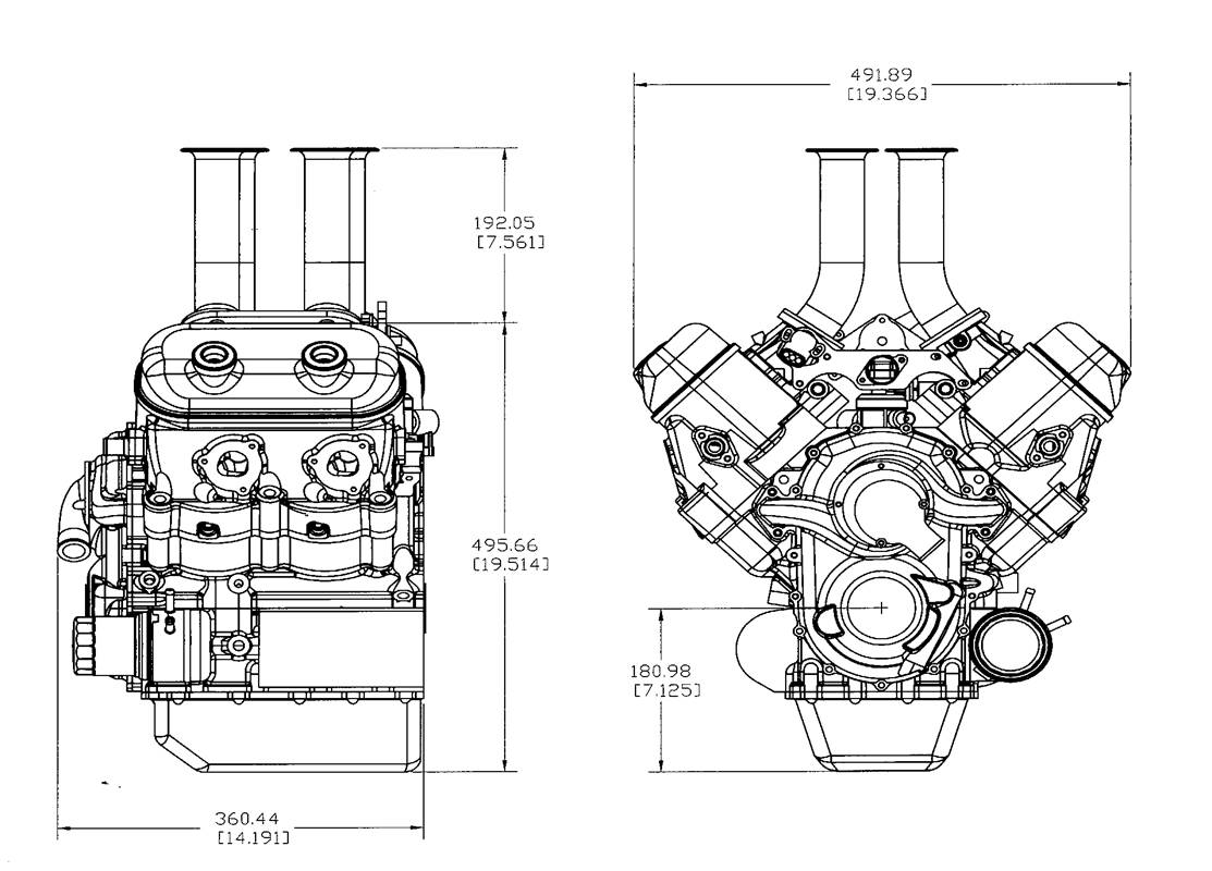

The main problem I see with the V4 is that it would be almost exclusively a RWD engine which would limit the number of models GM could use it in. You might be able to get it into the Impala or Lacrosse, but FWD models smaller than that most likely wouldn't fit.

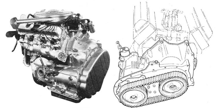

I think a point of clarification is in order -- developing a brand new engine architecture is expensive and producing it is even more so because of the need to start an entirely new logistics chain. Developing a variant and/or producing it is generally not.
For example, when GM didn't have the a DOHC 16v engine developing the "Quad 4" was a big deal. I also didn't go that smoothly in the beginning. However, GM has no issue producing the LS7 V8 which was used in a very limited number of even fewer models -- namely the Corvette Z06 and now that this is being phased out the Camaro Z28. They also had no issues doing a 2.0L version of the 2.2 Liter Ecotec fortified with an Eaton M62 supercharger specifically for a few thousand copies of the 1st gen Cobalt SS. Or, does anyone remember, the 4-cylinder 2.8 and 2.9 liter Inline-4s which were cut down versions of the "Atlas" DOHC Inline-6 (LL8) which were used only in Chevy Colorado and GMC Canyon (which accounts from less than 1 in 20 trucks or SUV that GM sold.
The V4 was proposed because it can do what an Inline-4 or Flat-4 turbo cannot. It allows the interior space to be about 6 inches longer with the same wheelbase by allowing the engine compartment to be really, really short. It fits where a flat four of similar displacement won't because of width. It fits a supercharger in the valley of the block in a way that an inline or even 60 deg V engine cannot. It offers about 300hp from 3.1L which at a mild 9 psi of boost, yet exceeds the power level of a 22 psi 2.0T at a similar weight with no turbo lag. It would not have been economical had the LT1 not existed and GM relies on a line of DOHC V8s just like everyone else. But GM has the smallblock card to play that no one else does. It is a application specific engine with very little application outside a compact front engine / rear drive vehicle, but the same can be said of the 2.0 4U-GSE Flat-4 in the FT86 (FR-S / BR-Z). In fact, if you optimize it for regular gas it may make a decent entry level truck engine if GM is interested in making mid-size pickups again. Otherwise, it'll be a limited volume engine like the LS7, LK5, LLV and LSJ, which is fine.

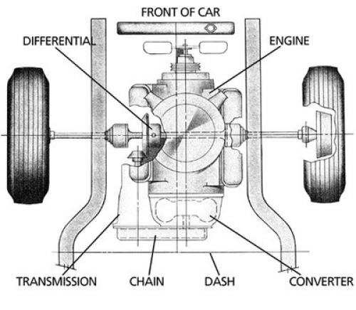

I think I would be more worried about the transmission tunnel in the car more than the few inched that engine would provide.
Think back to the Monza and the large driveline tunnel in the car and how much space it took up.
Also shorter the wheel base the poorer the ride tends to be. Many cars today have the wheels moved out as far as possible to give better ride and handling.
I think I would look at ways to cut the tranny size or a light weight rear transaxle to remove the large tunnel in the car and create more room where a car like this needs it in the front foot wells.

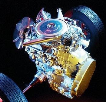

That is exactly why you want a very short engine. The transmission is widest at the bell housing. Keeping the center of gravity of the engine where it is, if the engine is very short, half the the reduction in length goes towards moving the transmission FORWARD which widens your foot well space. The V4 is basically a foot shorter than the V8 or an I4. Half of that, about 6 inches, goes towards moving the entire firewall forward giving additional foot well width and depth.
The other way of course is to move the transmission to the back and use a rear mounted transaxle.The problem with that is that for most cars the height of the rear bench and or the width between the rear seats are simply not suffcient for that. In a vette this is not a problem because you have no rear seats and an elevated rear platform, but this isn't so four most 2+3 or 2+2 configurations. Another bad thing about a rear mounted transaxle is that you need to carry your engine torque to it with a fast spinning torque tube going the length of the central tunnel. This, like a heavy flywheel, reduces the rev response of your engine. Not much of an issue for a 465lb-ft V8, but in a smaller engine that needle will rise and fall at a slower rate affecting performance and driving experience.

I was interested in the K tech engine and did some digging.
The engine is not really half a LS 350.They like to think of it as a 3/4 version.
In the story I read it said it appears as a half a LS but in truth it has was inspired by three engines. The LS, the Honda 1300 V4 and the Ducati Desmosedici.
The truth is other then some of the general lay out the LS really shares little here. The only shared part is the Cam gear. It shares similar lay out of the ports and valve train but the engine has all different spacing and measurements. Other thean the sprocket it has no shared parts or specifications.
This was intended to be a light weight bike engine and not really anything for a car. They did use a VW dune buggy for testing and I can see a use for this in a sand buggy.
Check out the story in the Sept 2011 Hot Rod as it was the best story on this engine. It is interesting but I think it shows how that to do this right you really need to do more work than just lopping off 4 cylinders.
They even explain the odd firing of this engine as being better to help the rear tire recover between each of the 2 cylinder fires. Take time to read the story as it is neat what they did. Also I can see why GM is not involved as it was not their project or really their engine.

Because a 90 deg V4 is very short, but wide. When you place it in a transverse setup, it requires much more engine bay length than an inline engine or a 60 degree V6. More importantly though, in a transverse arrangement it has no advantages over an inline-4.

Ooo. Good question! It could use the same transmission layout as my Toronado or the Dodge Intrepid has.
Why is there a notion that this engine will not move a FWD?
But why restrict to transverse setup?

Actually, no. The Longitudinal FWD transaxles have the differential and output shafts located just behind the torque converter near the bell housing. This is generally inline with the front wheel hubs. It means that generally, the entire entire and usually a part of the transmission (namely the torque converter or clutch assembly) overhangs the front wheel axis.
Any possibility in reverse-mounting the engine; putting a V4 behind the transaxle & moving the front axle as far forward as possible, with the transaxle out front, in the name of balance? I guess it would make for a really long hood.
The balance is bad in Audis, but in other setups, not so much. With a V4, in this setup, you could still have the engine mostly aft of the front wheels. In the intrepid, there doesn't seem to be any more footwell intrusion than any other FWD car.
Not always.
Another view.
The front axle line is ahead of the rear two cylinders, so in a V4, the engine/transmission would be primarily to the aft of the front wheels. The caveat is there is no real limitation to how far ahead of the engine you could put the front wheels.... Not that you'd want to, but you could build a rear engine-front wheel drive set up this way.
