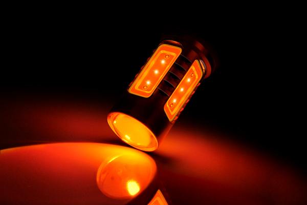

Swapping in these LED bulbs requires some research. In some cases, the bulbs are not as bright in RL as the specs claim. In other cases, the load is so low that the flasher relays (or other components) will not detect the lights and will malfunction... requiring resisters to be hacked into the wiring. The resisters, in some cases, get hot and are another problem entirely.
I bought a few of these bulbs a few years ago in popular sizes... 184, 1157, 1156, etc... I did not like the light pattern or brightness and they got tossed.
No doubt they have gotten better... but sorting out the garbage from the good is a PITA.
^ Agreed RE the temps: the LEDs in many cases run hotter. In smaller housings it may be an issue.
