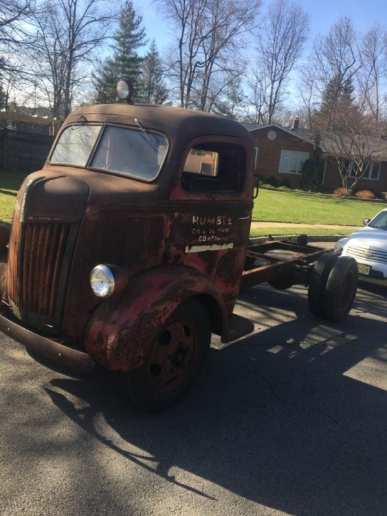

Ran her outside for insurance / DMV pics, then back in- no problems to report. Truck idles in 2nd gear with no pedal- she's turning out to be easier to drive than my recollections of modern 4-spds…. tho I reserve judgement 'til out on the road and hitting 4th.
Very cool pic, does your DMV require mud flaps? Going to add anything to the back or just run it as is?

Just read your entire thread with interest  as I just purchased a 1940 COE, Congrats on the great journey with your truck. I most likely will be in touch for advise (c;
I'm a new member here and sadly  I can't view your photos for some reason. What part of NJ are you in? I'm in Albuquerque NM but visit NJ to see family I'd love to see your truck
This is My COE as purchased
