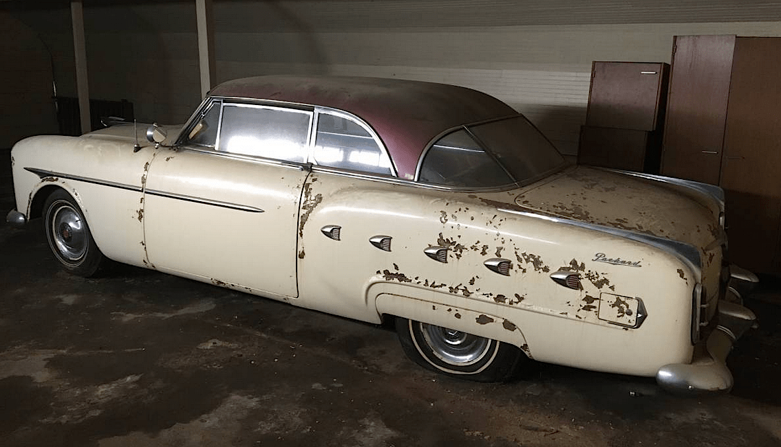

'53 Packard Mayfair ~

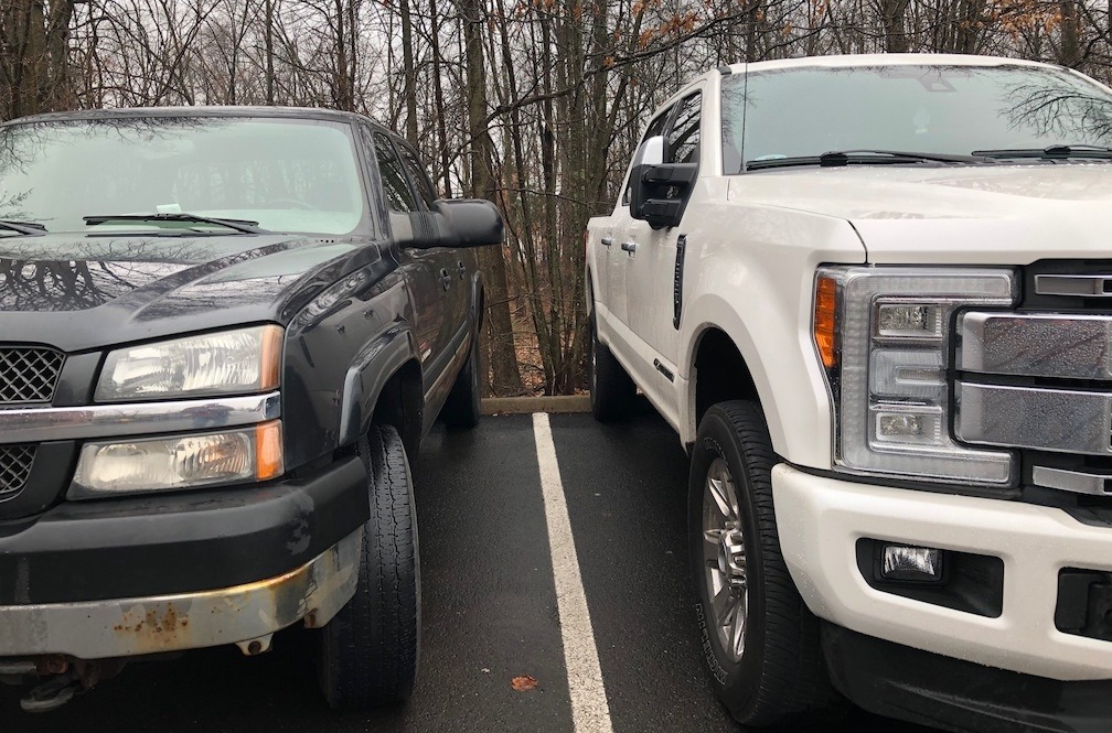

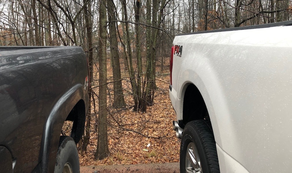

Interesting & telling juxtaposition : two 3/4-ton pickups, about 16 years apart.
The lengths and widths are the same, but the HEIGHTS are noticeably different.
The cowl height on the F-250 is about halfway thru the 2500HD's windshield.
Park a new 2020 Sierra or Silverado HD next to your older Silvy HD, they're a lot taller as well, all domestic makes are getting to be gigantic.

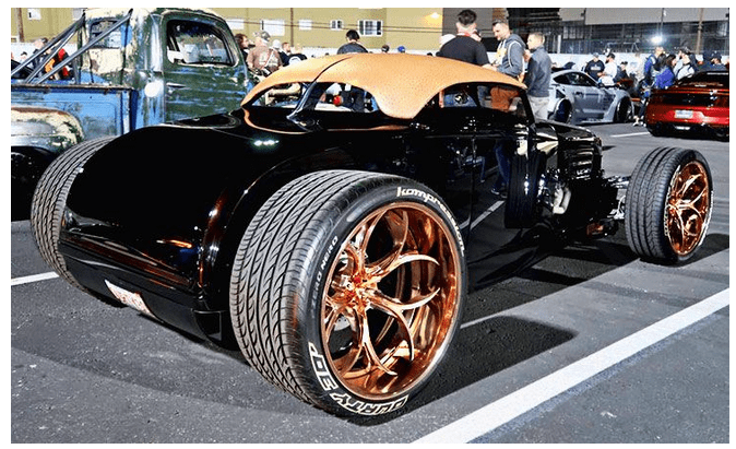

penny for your thoughts, whoa
6 hours ago, dfelt said:
I help ya out and give ya a Dime! :P
Aw thanks but I was commenting on those bitchin' copper rims

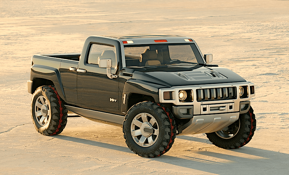

I can easily see some of the new Hummer EV having this style in it. Lots of people loved the look of this truck.
