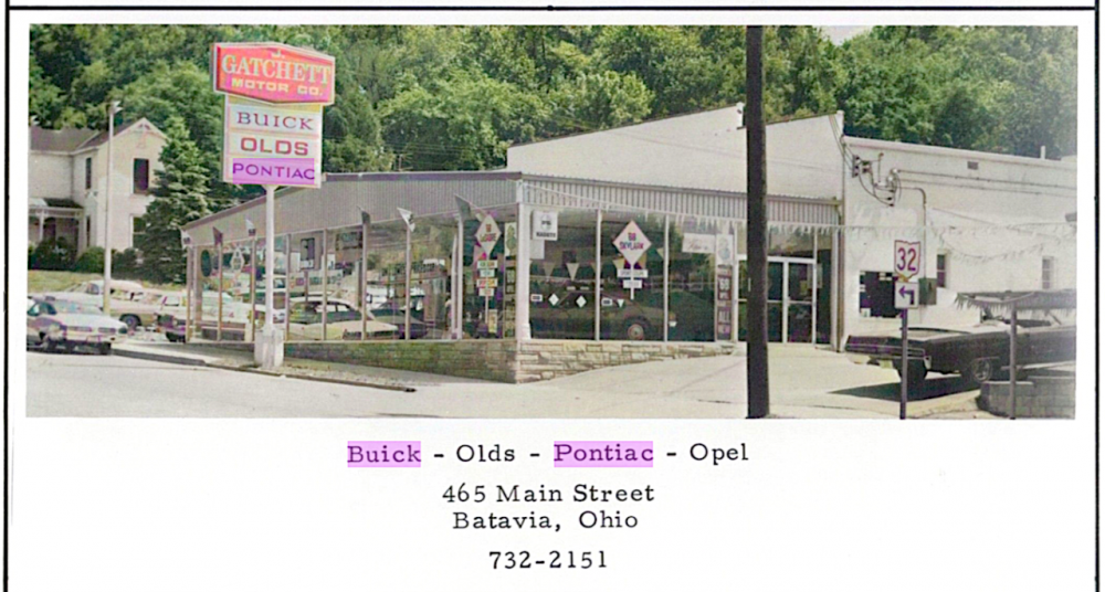

Gots 1,270 dealership photos in a file, and more trickle in all the time. Neat stuff.
Chenoweth Pontiac-Cadillac-Rambler, Wilmington OH ~
  • 4 weeks later...
Now up to about 1470 dealership photos. Still around 4600 coded, up to almost 8700 dealers total.
