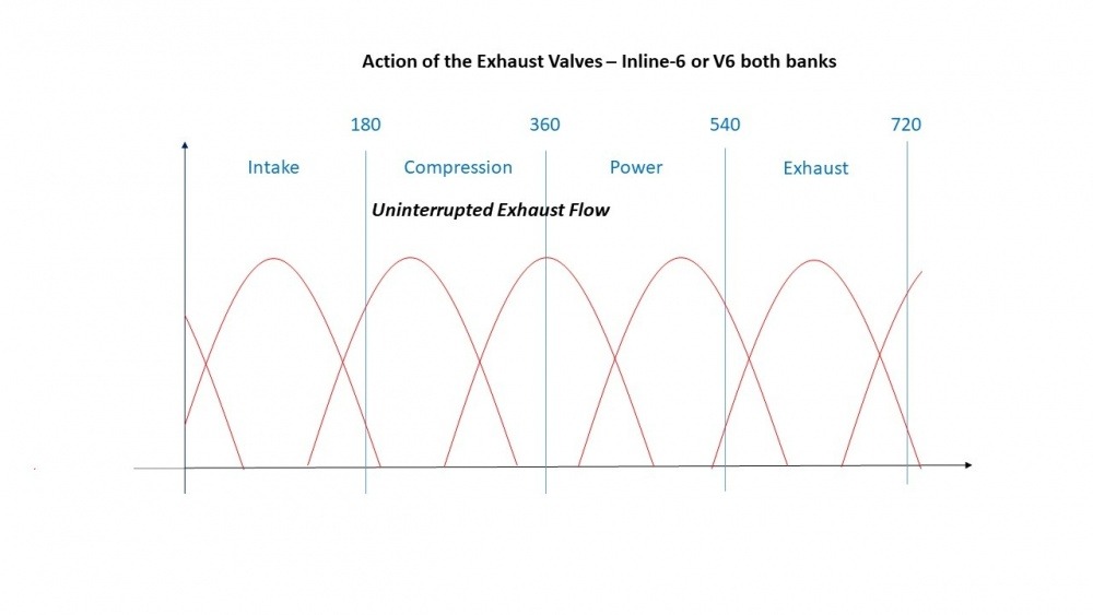

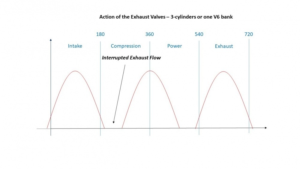

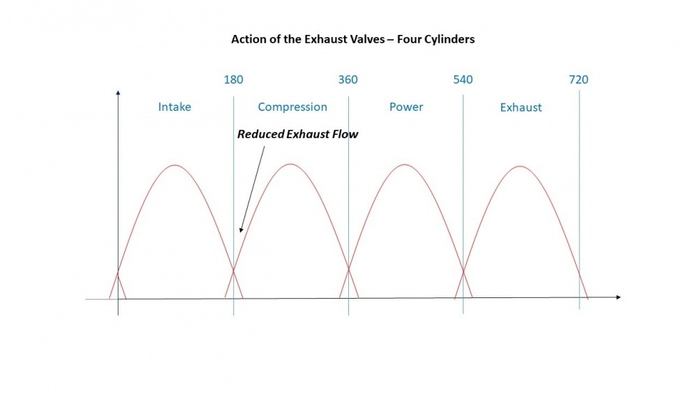

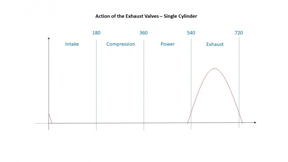

The reason is very simple. And, it is not something you can conquer with expensive turbos or fancy materials. Just look at the diagrams below...
In a 4-stroke engine, the exhaust valve opens once every two rotations of the crank for about half a rotation of the crank.
In a 3-cylinder engine, or any bank of 3-cylinders, exhaust flow to the turbo is interrupted for significant periods with the exhaust valves closed on ALL cylinders. A V6 Bi-turbo engine is essentially two Inline-3s with each turbo is feeding off one bank of 3-cylinders.
In an Inline-4, one exhaust period is always beginning while another is ending. Hence, while exhaust flow diminishes, it never really falls flat completely.
In an Inline-6 the periods overlap generously ensuring a continuous exhaust flow to the turbine that does not diminish appreciably throughout the entire cycle of the engine.

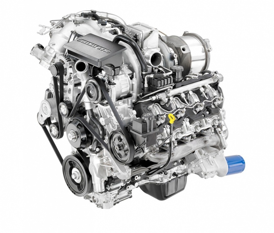

Note that the Duramax is a diesel, though.  Is anyone doing single turbos like this for a gas V6?
I don't think so. And the Duramax does not have the hood heights issue. Pickups have lots of room under the hood.
Nope, but they should for a mid-engine sports car. I think ford wasted a good opportunity with the Ecoboost V6 Ford GT. These have a lot of height in the engine bay if you don't mind seeing the engine in the rear window. The Audi R18 Le Mans race car is a hot vee single turbo 3.7L V6. But that is (oddly enough) a DIESEL Le Mans race car, and that doesn't constitute a "production" engine.
The C8 is unlikely to use a hot vee single setup since it is a V8 and that is as good as an I4 which is good enough.
