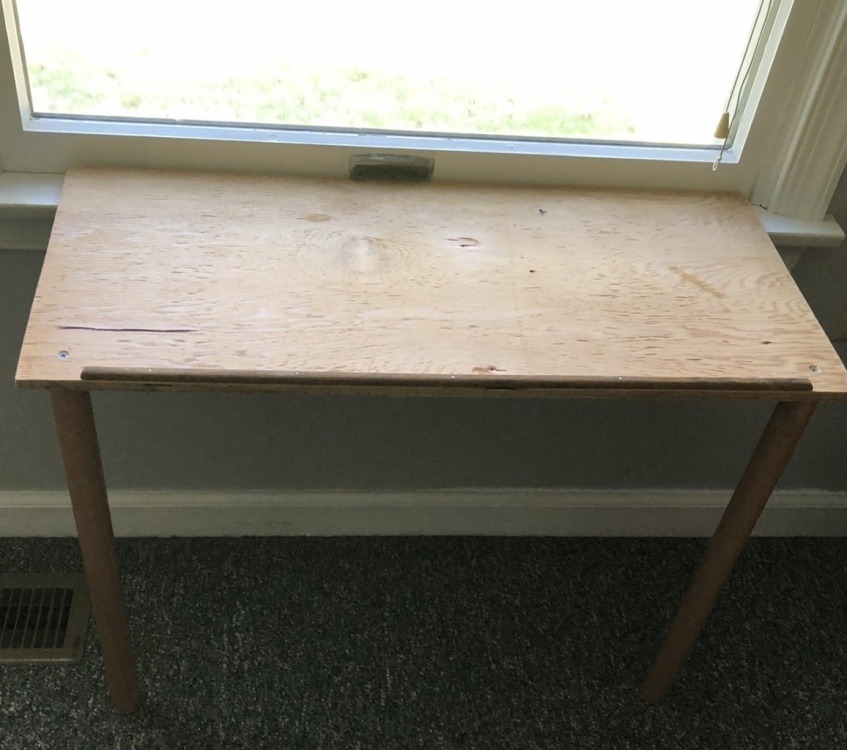

Well, the current 'house arrest' scenario across the country is going to force folk to amuse themselves in new ways, perhaps trying something new or different.  So this here thread might be a spot to post up some 'projects' people are working on, even if little stuff, to pass the time productively.

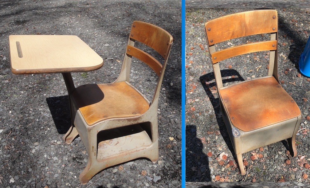

I had this '50s school desk for prob 12 years now- came from a garage clean-out. Super clean, but I advertised it a few times and took it to a swap meet a few years ago- plenty look but there's no takers. So (because it's not built for adult-sized humanoids) I tossed the top and cut the steel post off, now I have a lil shop chair. It's not too low for adult humanoids to sit on, tho it's not what you'd call incredibly comfortable. If I end up never using it, I'll toss it, but here's a chance at a 2nd life.
Whatcha workin on?

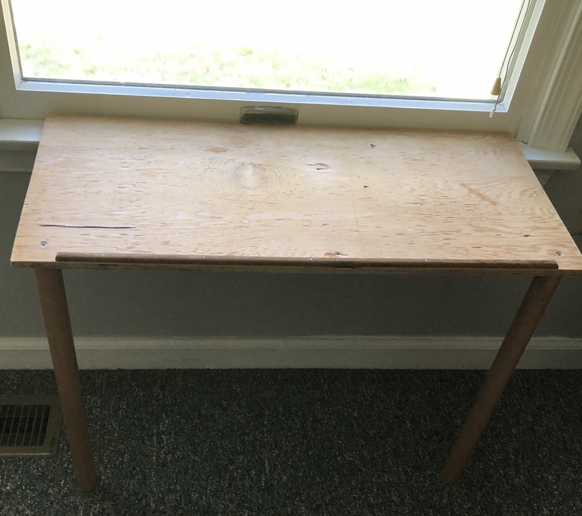

^ A few hours after I cut the above desk, rendering it a mere chair, someone contacted me to see if it was still available. ?

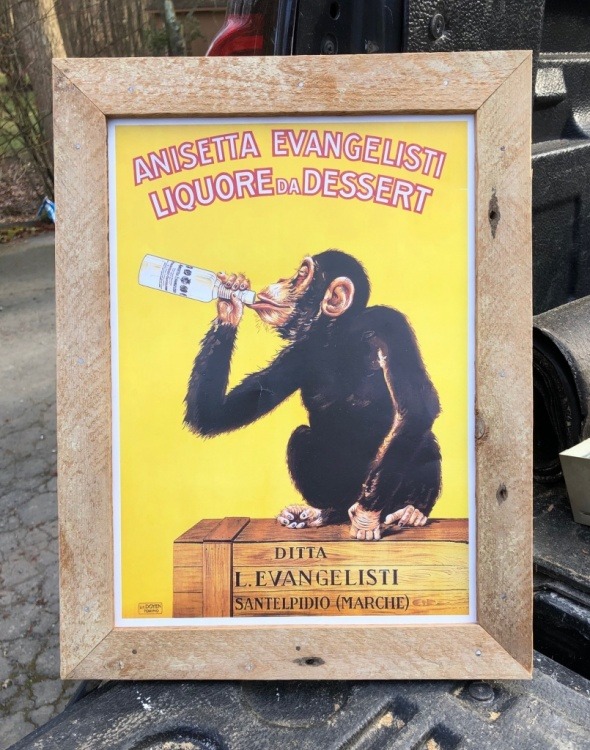

My son & his girlfriend had this 'drunk monkey' pic they liked, so I whipped out a frame made from lathe I had in stock- it came out of a house that got gutted of it's plaster because the homeowner 'hates cracks in plaster', so we drywalled the entire 3-story house, originally built in 1880.

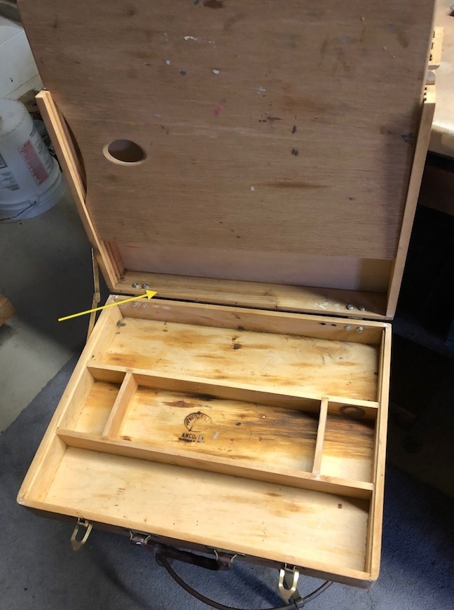

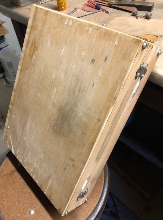

This was my mother's 'painting box'- it's prolly from the 50s. Certainly not a quality piece... but thought I'd at least make it structural again. Top & bottom are plywood, which was all coming delaminated. So over a period of evenings, I glued & clamped it various ways, plus used wood filler in some sports. Had to repair the rear of the lid where a jagged section was missing, making the hinge on that side non-functional. Anyway- it's back together. Mom (& dad) paint regularly, but I don't expect she'll use it, but maybe she'll enjoy having it again; she has a studio room down her basement (I think it's been in my stash of stuff for over 10 years now).

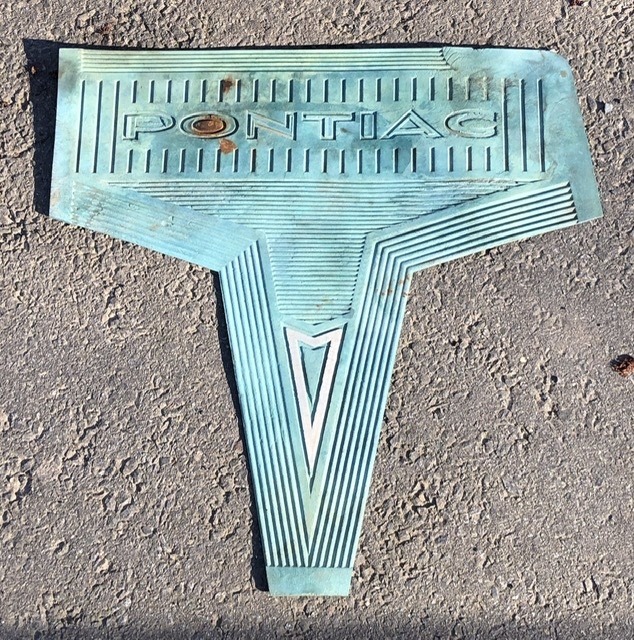

An original floor mat out of my now-gone ‘64 Catalina. It was torn across the top (2 pieces), so rather than just toss it, i made some low-brow wall art:

I remember using that style of desk in elementary school in the late 70s.  Same details.

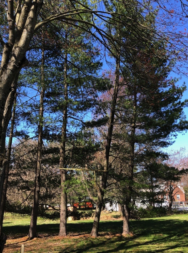

These are the neighbor's white pines. The ground stays wet often right where they are, and white pines have poor root structure; in wet ground with strong winds they go over. This is the latest one to start flirting with the ground from afar. I put a car ratchet strap on it - it's rated to 10,000 lbs so it should hold. But the tree has to go; now to get the neighbor to pay for it.
For a sense of scale, I'd say that yellow strap is about 14' in the air.

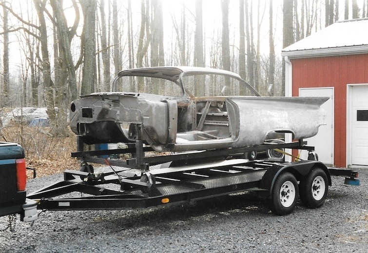

I took the body off the frame on my B-59, never knew anyone before that that did that job. I may have read one article in a car magazine. Seemed common-sensical to me. I also fabricated / welded the dolly its on in the below pic :

That is how my dad did stuff too.   He did all kinds of stuff around the house. And when he wanted to make more than one of a particular object...he created jigs to replicate that very object he wanted fabricate.
Working at Canadair and manufacturing aircraft, he learned that skill as that is how aircraft production was made back in the day.
It's awesome Balthy that you could work with metal to fabricate jigs like that. And I bet you could work with any metal you could find.  Scrap metal or otherwise!
Off to the paint shop?
Epoxy primer. It had the lower rear quarters & rocker replaced, and the initial bodywork there wasn't right, so it got stripped off (the filler) and redone also.

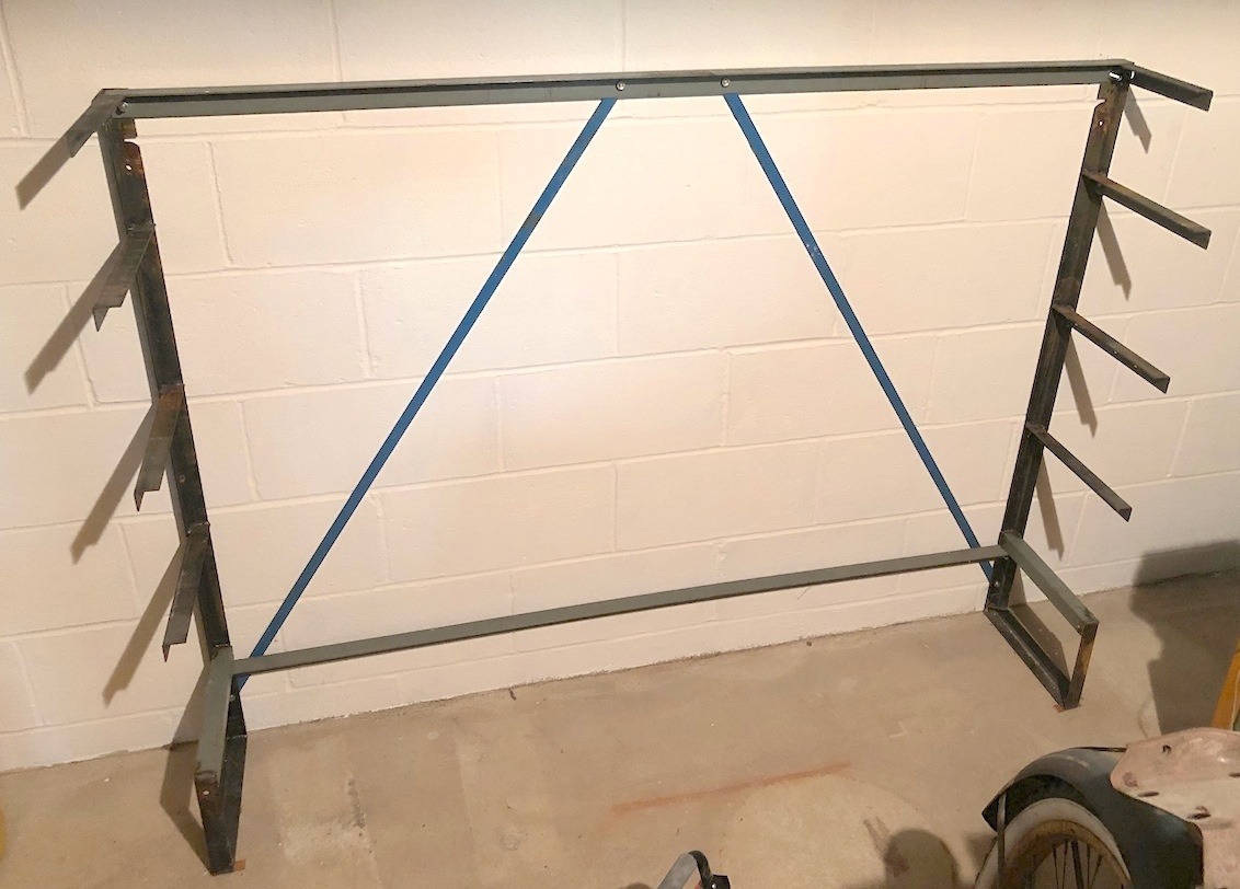

I made this rack years ago, but in the course of purging & re-arranging things in the basment, this is the first time it's been naked since I made it. Fabricated from an old iron bed frame, it's to store long pieces of lumber/trim. Never know when you need an odd piece.

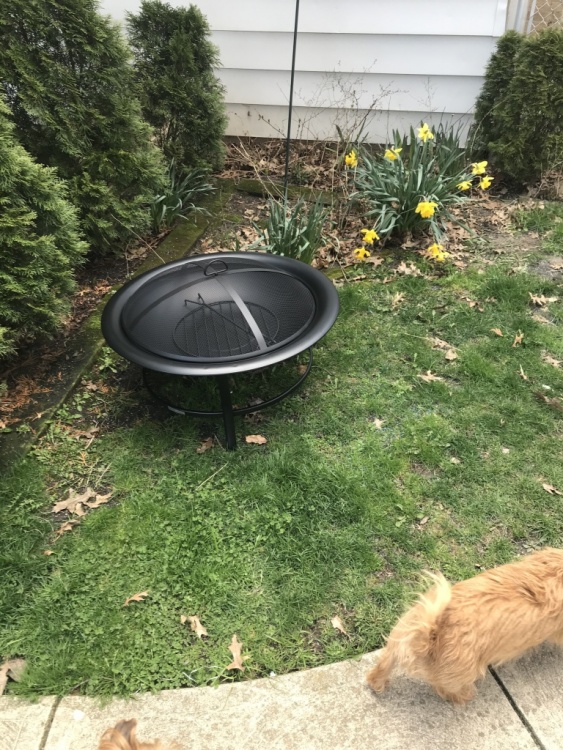

Put together this fire pit from a kit from Home Depot, light enough to carry out to the yard or patio.  Got a box of birch firewood.  Should be fun for evenings out in the yard...

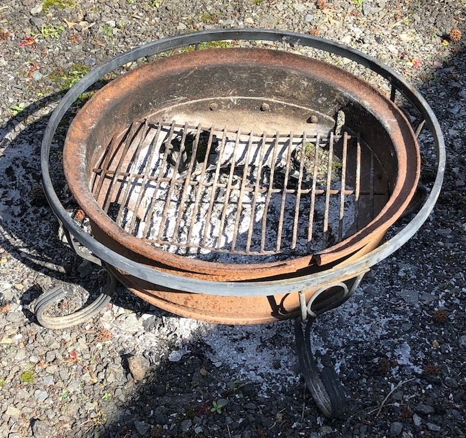

Here's my hillbilly fire pit: the base to an actual one, a rim that would fit my '40 except someone prior to me inexplicably cut the center out of it, and an old grate I cut to fit in it.
If I were to use it as a fire pit, I'll have to put some steel screen across the bottom. To date, I've put it on the ground without the firepit stand and used it to burn papers when I have too much for the wood stove.

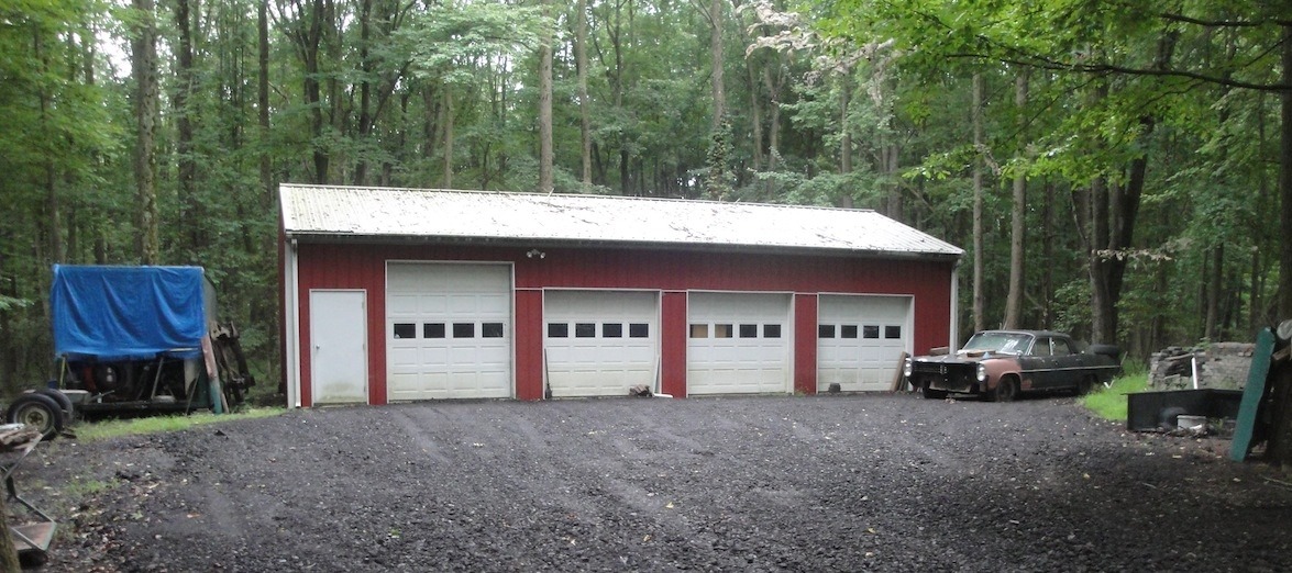

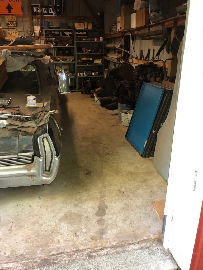

Worked in the shop today, it needs it's once-every-3-years cleaning. Always of the mind to organize & purge. Made good progress, more tomm.
Been a long time since I posted a pic of it (if I ever have), here's one from 2013. The '64 is gone, and the green container box has a hinged door on it instead of just a tarp.

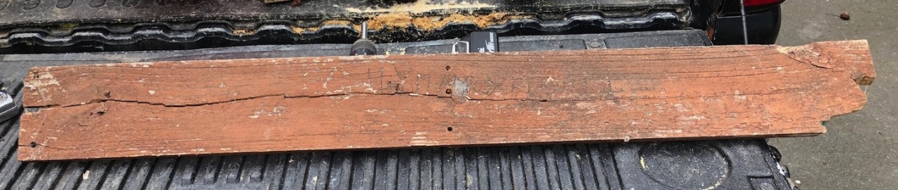

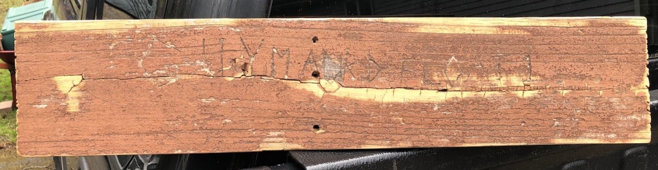

Another quickie today : My family had a cabin on a lake in NY State for decades, and we had a float out in the water to swim to. My son carved into the sideboard of it years ago. When we sold the place in '13, we broke up the float, but I saved this one board. I cut it down, drove two 4-in screws down to hold the crack/pieces together, and gave it a light sanding. He's going to deepen the carving and wall-hang it. Before / after :

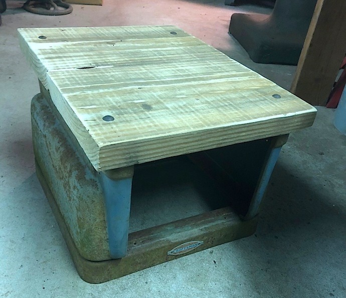

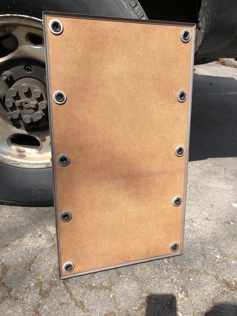

This is the steel surround for a '50s Craftsman table saw. The guts were rusted up, so I scraped them, but this shell has been sitting around probably 2 years now. Had some scrap 2x10 so I made what my buddy calls a 'step upon' - it's pretty sturdy and a lil over 11" tall.

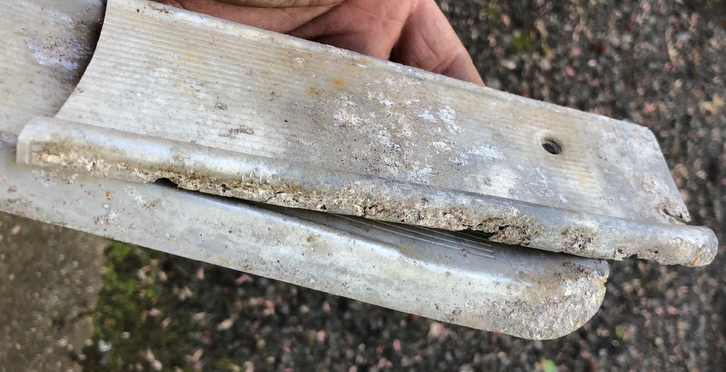

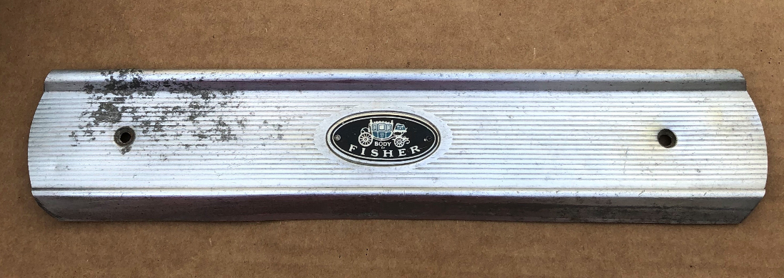

About all that's left of me once daily '64 Catalina; both rear door sill plates. They are rough - not good enough for driver quality (besides I believe repros are out there). Since my disease doesn't readily allow me to throw out automotive pieces older than me, I came up with a plan. Kept the center section, and radius-cut the 2 bad ends off. Some steel wool and Poof! another wall hanger.

On 4/22/2020 at 12:54 AM, balthazar said:
Apparently I have a bunch of 'quickies' in me.
I need this for when I need to make a point on the internet.
It’s available for rental.

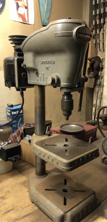

Here’s my trusty ‘64 Sprunger drill press, made in Topeka IN. Works great, use it all the time. Switch went bad so it got a new switch, new grounded cord, and cleaned up/waxed the vertical post & table. Maybe I’ll restore it when I no longer need to put holes in things.

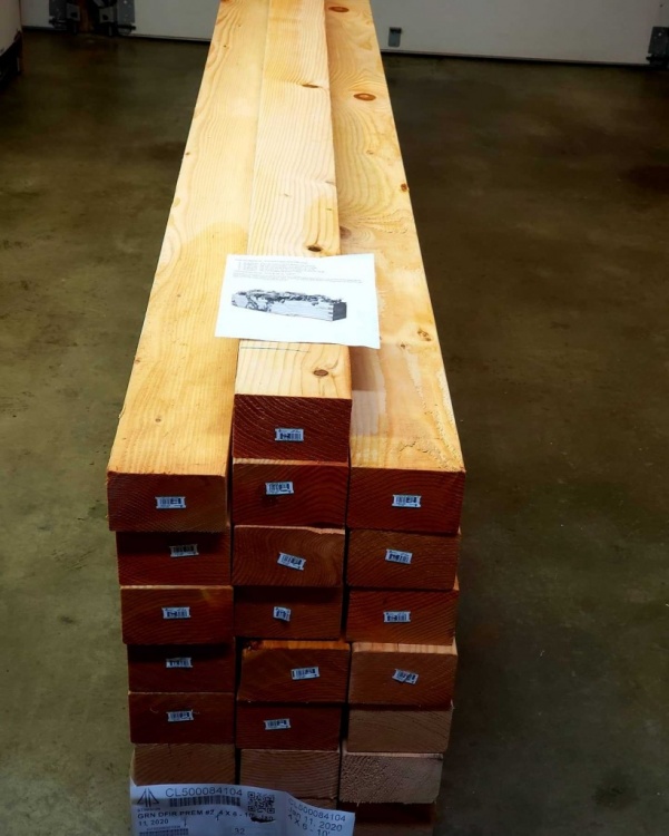

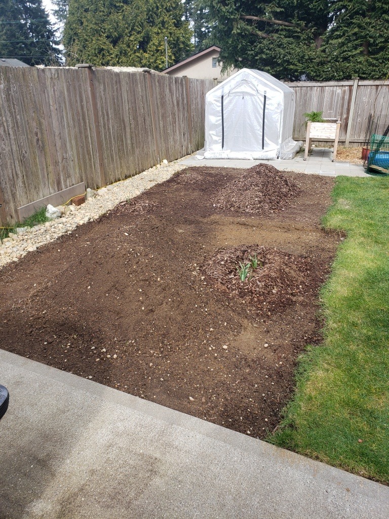

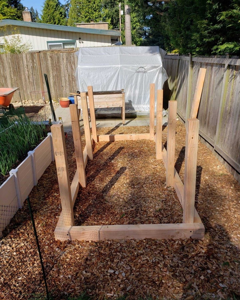

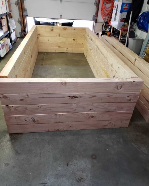

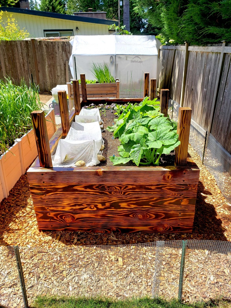

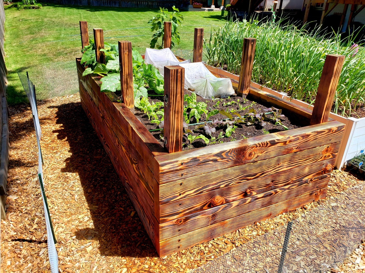

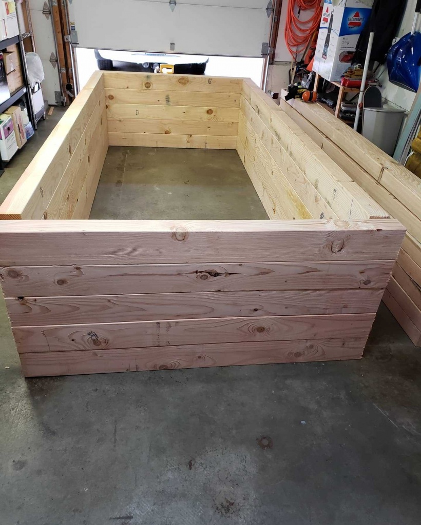

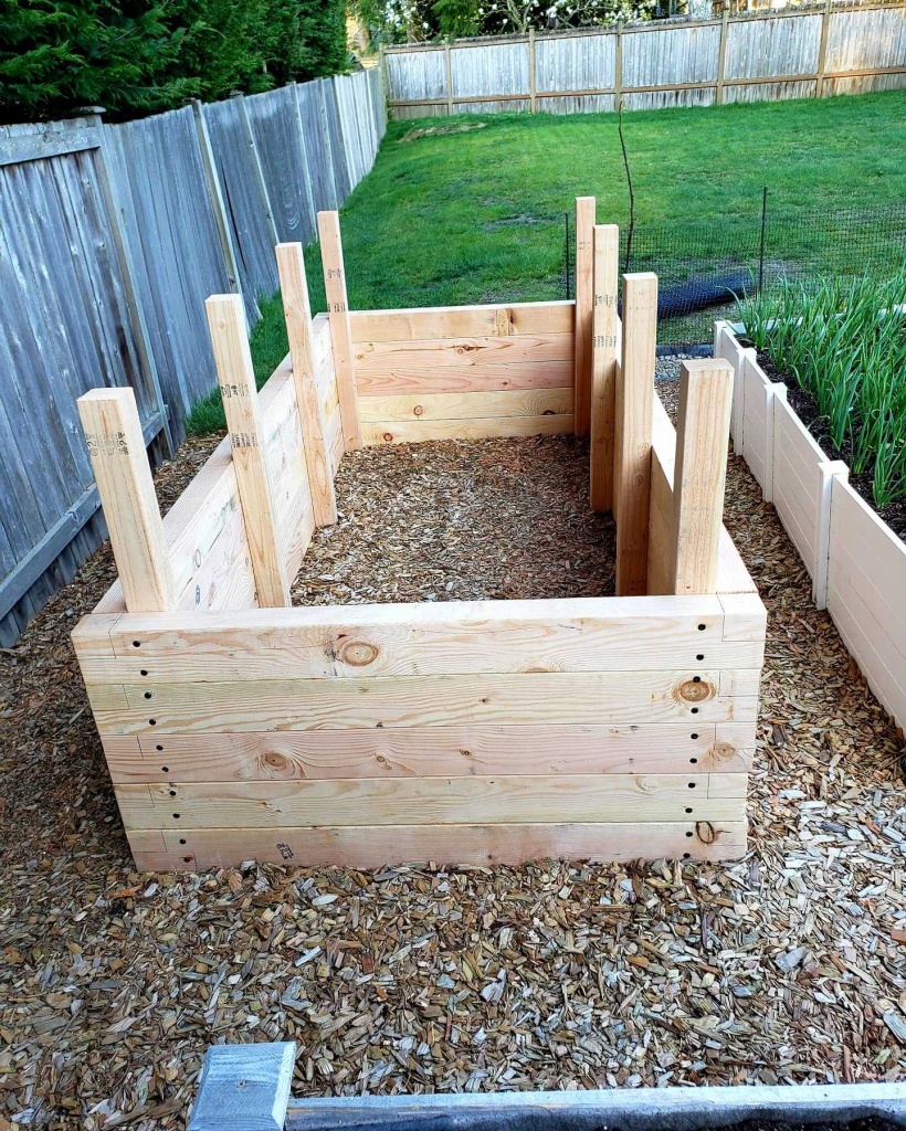

My other recent project was a bit bigger, the wife wanted an easier time gardening, so I figure why not build her a decent raised bed. The last raised bed was a 2ft high plastic bed, $400 from Costco. 3ft x 10ft x 2ft high. I thought I could do this better with natural wood. So off to searching the web and then Home Depot and here is my raised bed I built for the wife out of 4"x6"x10ft timbers. This ended up giving me a 5ft wide by 10ft long 30" tall raised bed for gardening.

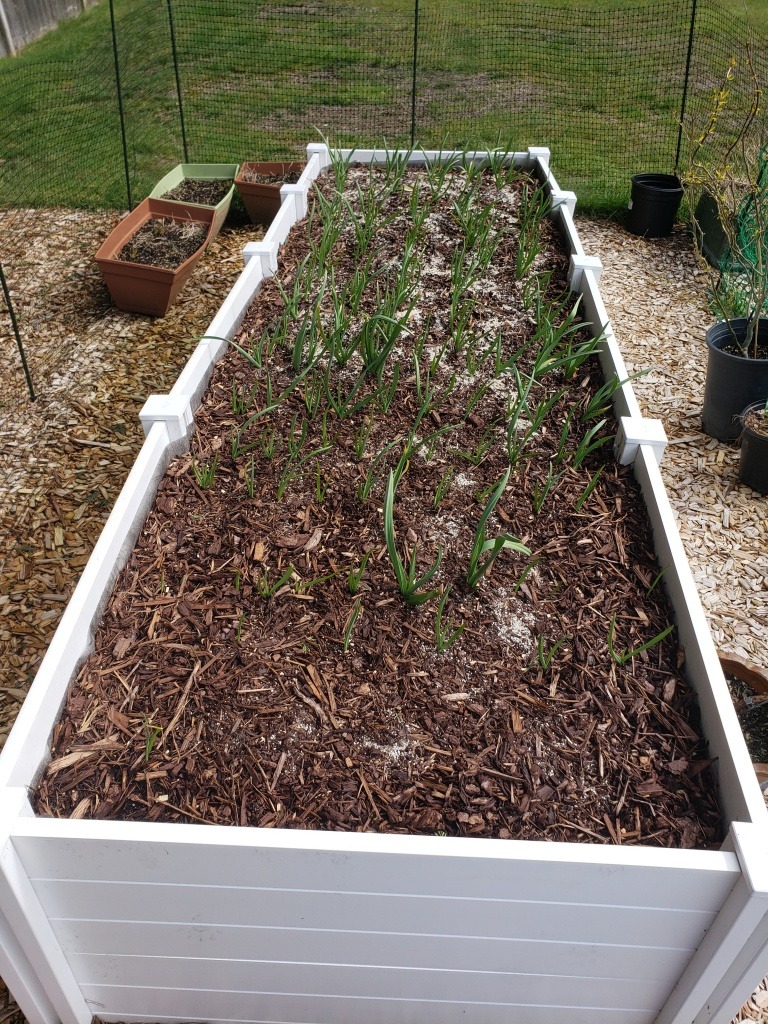

You can see the Costco plastic bed with Garlic growing, planted early winter to the left.

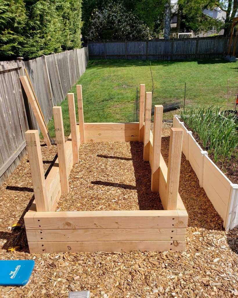

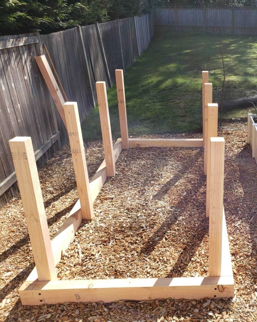

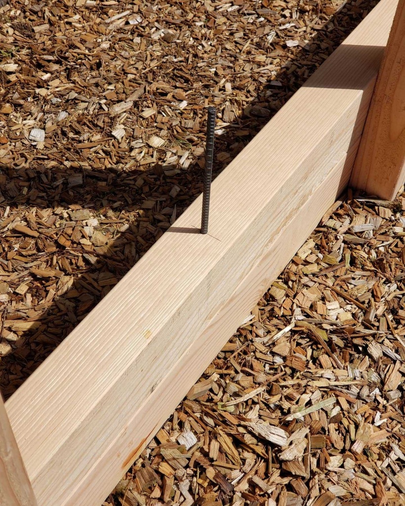

Stacking it into the ground. 3/8th rebar, 3ft long. 2ft into the ground, 1ft of wood. Drilled hole and then pounded the bar in.

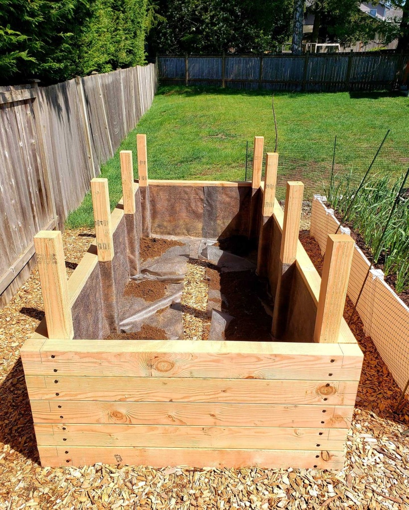

Finished bed with liner installed.

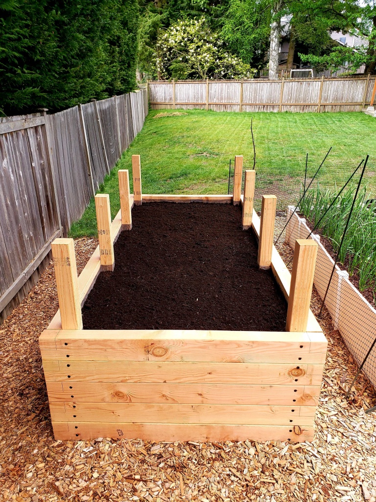

Bed filled with Black Gold compost / dirt. Great way to grow healthy veggies.

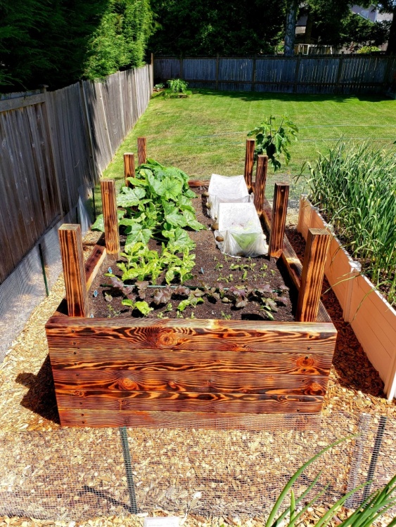

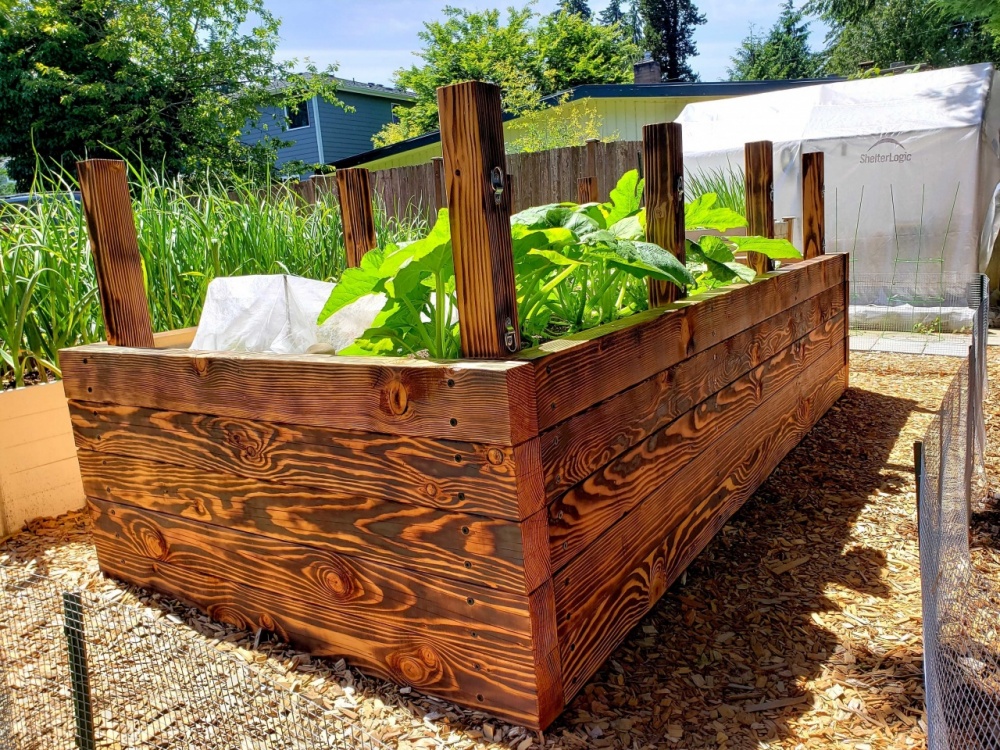

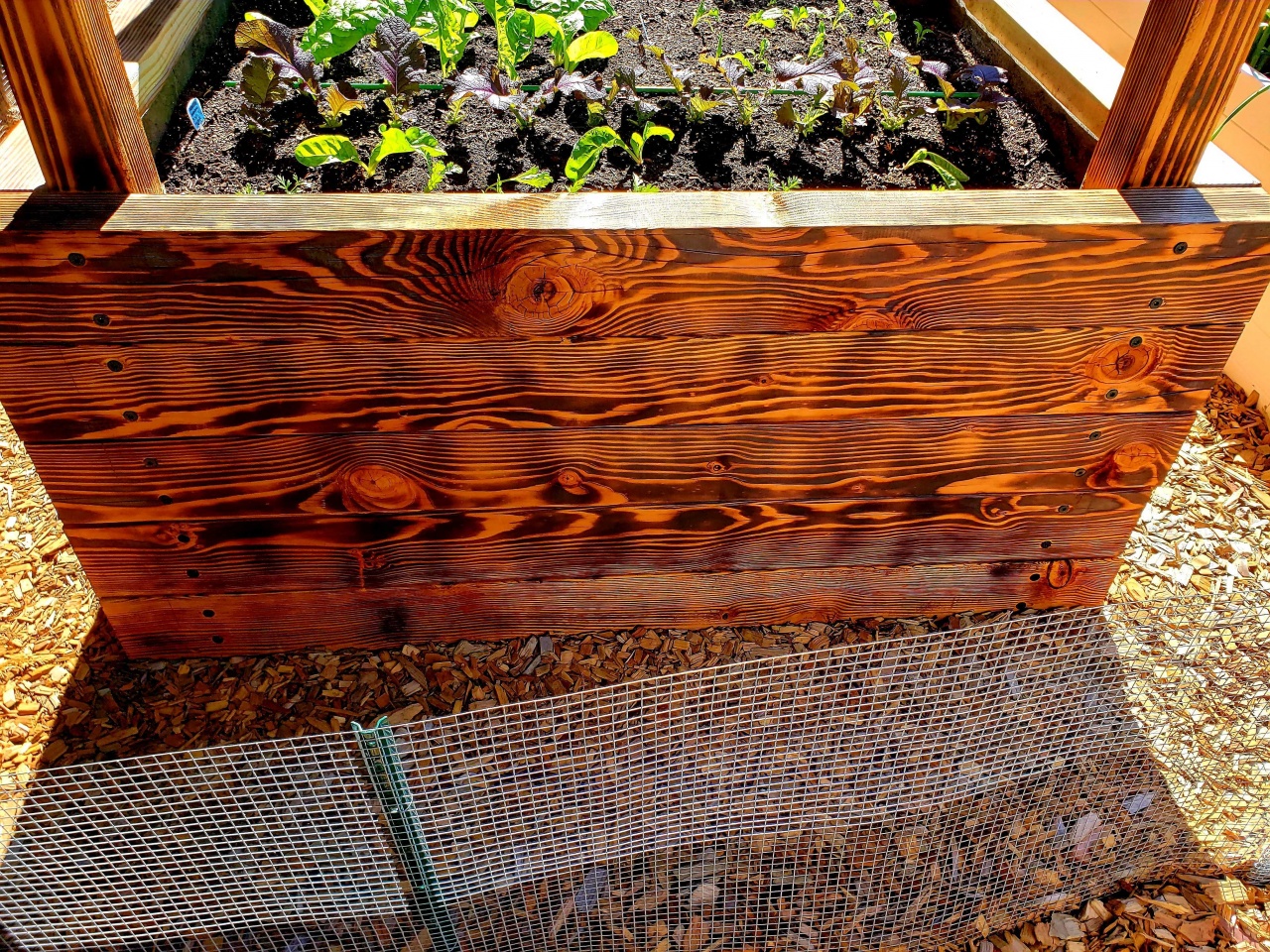

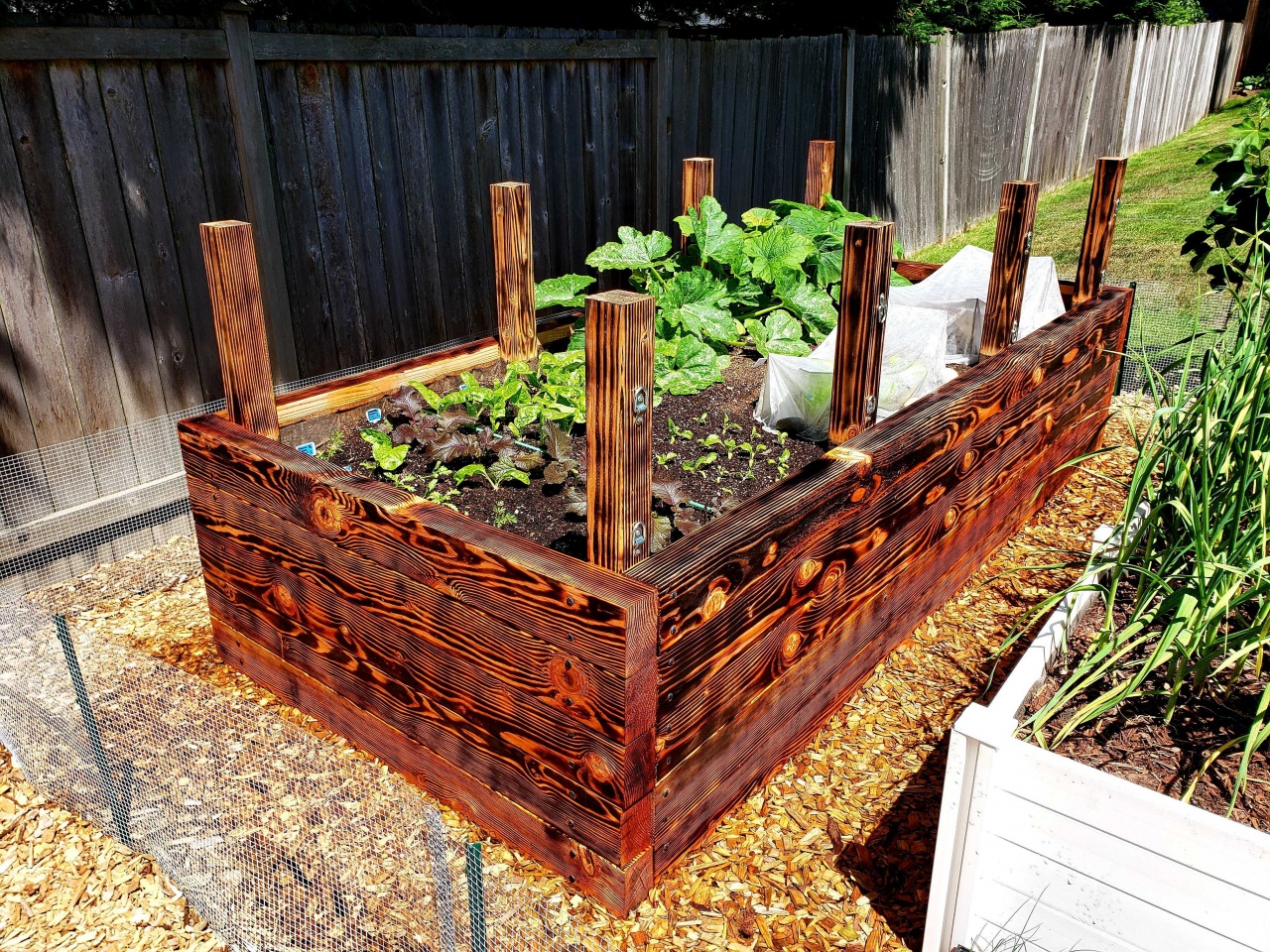

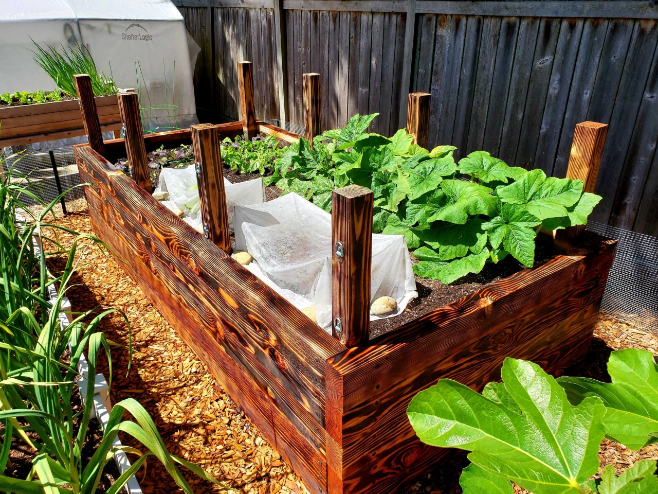

So the wife is on an organic kick, all things nature, no chemicals and as such I was researching various ways to make this last even longer then the estimated 15 to 20 years or so. As such a coworker introduced me to a Japanese technic of making the wood water and fire resistant. The technic is called Shou Sugi Ban. This is taking a torch to the outside and charring it and then wire brushing it down to have a harder wood surface. This take the softer carbon parts of the wood and harden it.

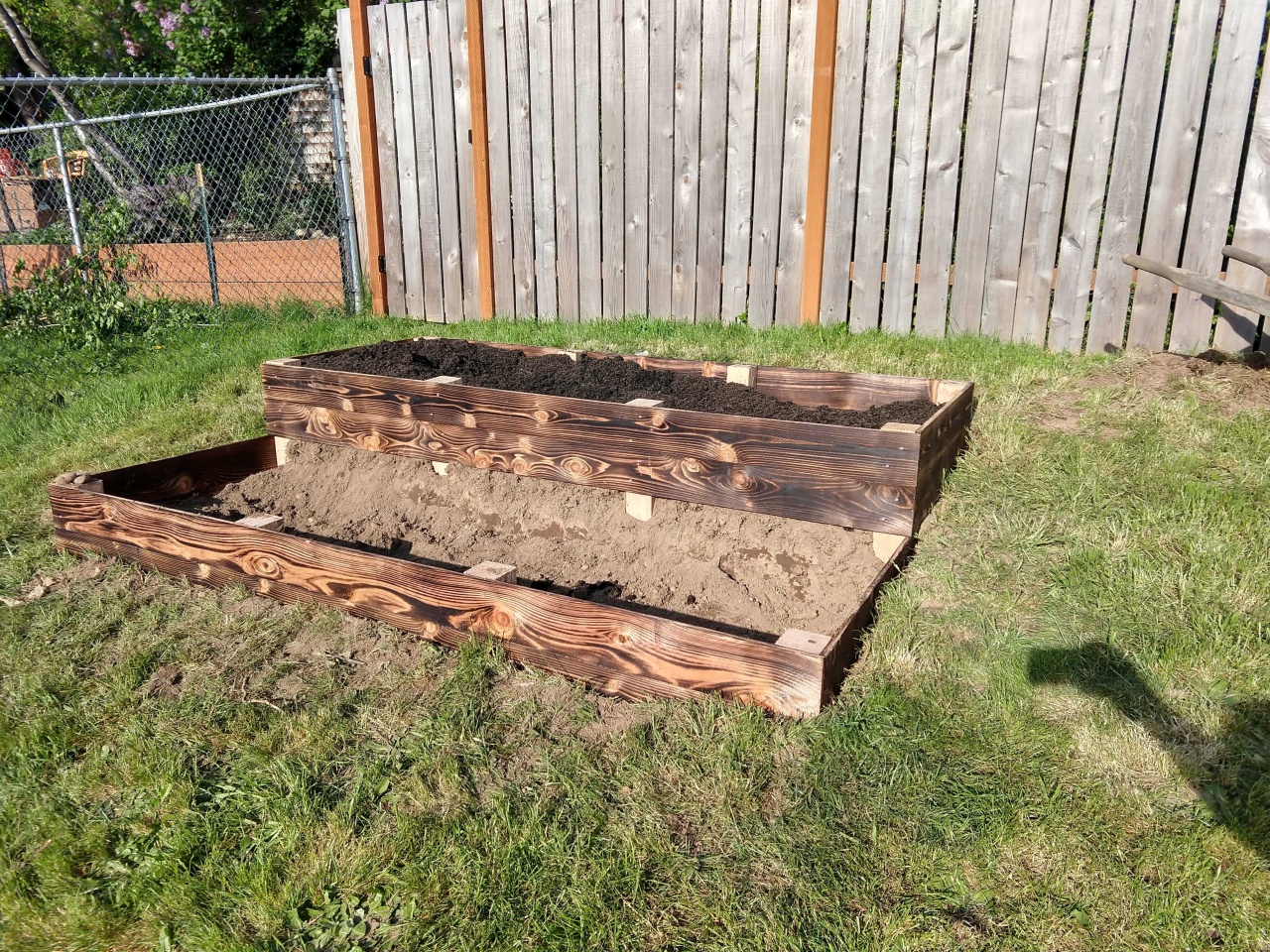

My coworkers veggi bed, in the future any more beds I build will have this done on the inside and outside first before liner and dirt is put in.
My Shou Sugi Ban veggi bed now that I have done the technic on it.
More info if your interested in the Shou Sugi Ban technic here on YouTube.
https://www.youtube.com/results?search_query=shou+sugi+ban+technique

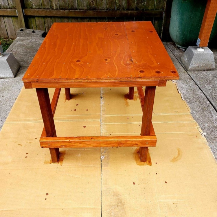

Cool table project done here on this same technic.
Mr Felt- question.
What's the purpose of the vertical 4x6s? I see you have D-rings on them.
Curious, because they're obviously not for structural reasons.
Mr Felt- question.

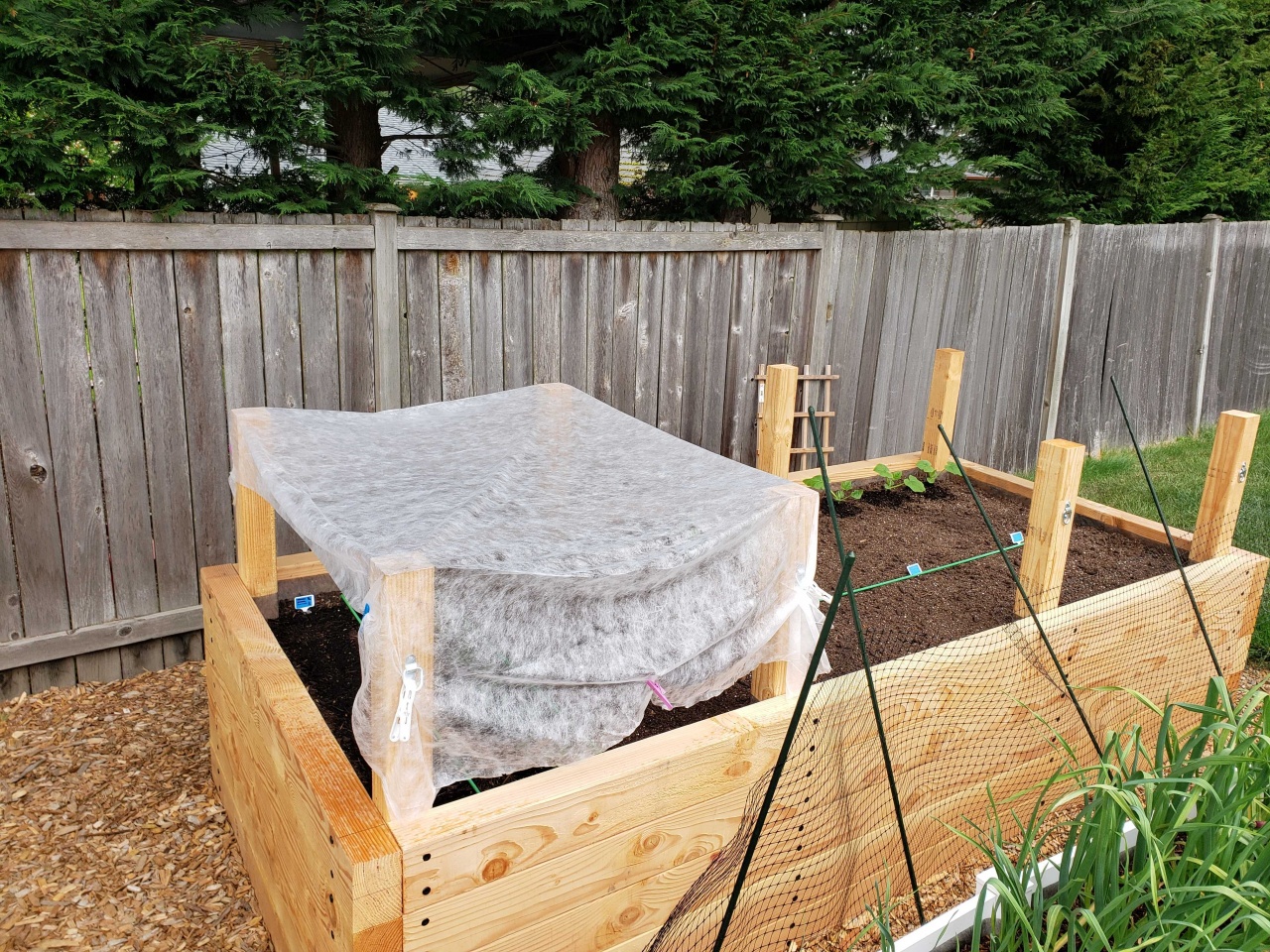

The 4x4 posts while having the 4x6 screwed into them are for tenting. This allows us to have from heavy clear plastic early in the year when frost is still possible over the starts planted to protect them to using the lite weight cloth coverings to keep insects out but allow rain to fall on the plants. At this stage except for the lettuce as this helps keep it very clean, the rest of the veggie plants are established enough to grow with out tenting needed.
Here is how it looked earlier this year after we had already gone from clear heavy plastic to just tenting against the sun.
The posts will also be used as I will secure some lattice work for the squash plants to grow up on and let the squash hang and grow big, but clean. Planning to secure lattice this weekend if it does not rain.
It will look like this.
Lattice also allows the plant while growing and keeping the veggies clean to spread out easier so it does not mildew here where we tend to get plenty of drizzle.

Believe it or not- this alley is the after pic of cleaning it out. There was a full sheet of ply, a spare B-59 hood, and a bunch of other flotsam that prevented walking down that side. Threw some stuff out, hood is leaning against the outside of the building until I can get it into my storage container.
Can't necessarily tell from this, but the car is shifted over (to the left) about a foot & a half past the door opening.
Going to return that snazzy piece of art to a car (instead of a shelf), air the tires, move it over, and roll it outside, wash it.
It hasn't been outside... I can't remember how long it's been. I remember it outside... dimly, once. My son has been itching to work on it, and even tho I can't mentally process major complex surgery on 2 vehicles at once, perhaps I should actually try.
