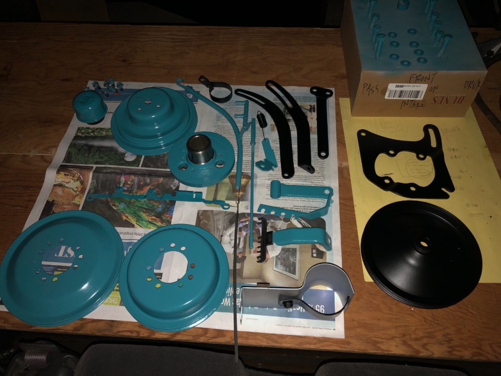

Restored bits collection keeps growing:
^^^  Hey...those are the UFOs...
How did you get your hands on them from the Feds, or CIA or even the MIB?
The black one is the Feds; the new 'black helicopter'.

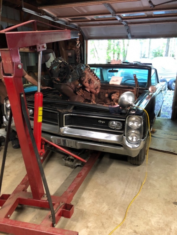

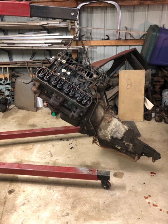

Motor/trans pull imminent...
Disconnected: starter wire, shift linkage, trans mount, some sort of heat shield, 1 motor mount bolt, speedo cable.
Left: other motor mount bolt, oil pressure wire, coil wire (to harness). Fun laying under a cob-web-dripping, rust flaking car undoing fasteners last tightened in 1964.
Talked to my friend who's motor is in the shop right now- he says maybe another week or 2. Them my bro's '65 GTO motor goes in, with a promised '2.5-3 month' turnaround. Then mine.

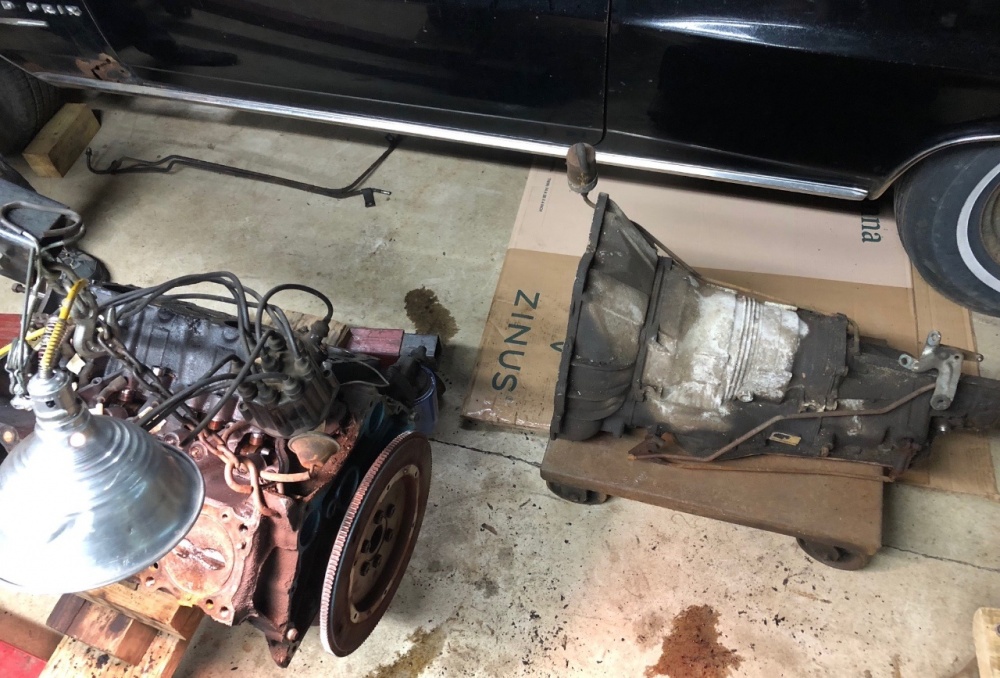

Bit of a pickle : with engine stuck I cannot easily disconnect the transmission. Need to rotate the flywheel to disconnect from torque converter.... no rotate-O.
Going to have to basically completely disassemble the engine and try to manual work the pistons free.
At least then you will learn what froze it up. Bummer though, lots of work to get it done. Wishing you all the best and hopefully once the one item that has frozen frees  up, it will go smoothly for you.
Drained the rest of the fluids out & took the heads off today. Nothing of note in the bore other than some old carbon. Wiped them clean, hammered on each piston with a wood block/hammer, squirted them up with plentiful Kroil, hammered again, tried turning but nothing. Will let soak.
Made 4x4 'pestle' out of wood, beat harder on the pistons, about 10 times in 2 circuits, and they broke free. Worked the crank back & forth, until I had free movement and numerous rotations. I suspect that the 2 cylinders that did NOT drain the Marvel Mystery Oil out were the culprits.

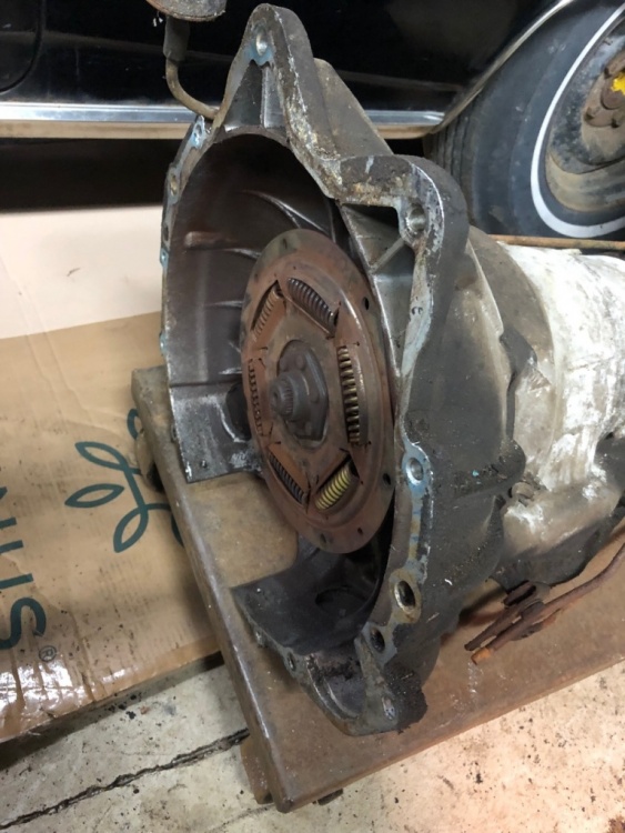

Got the trans disconnected and separated. Happiness.
Roto HydraMatic has no torque converter!

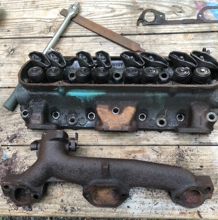

One side head & exhaust manifold separated. Had to heat each bolt, and heads were corroded enough to make me bounce between 13mm and 9/16 sockets. Overall, not too much of a struggle.

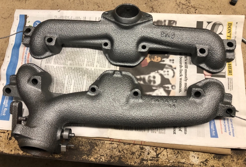

Got other exhaust manifold separated. Boy- a ton of rust came out of that one. I believe I can reuse these but they're going to take some clean up work- a couple hours worth, then paint them with exhaust 'cast iron' paint.

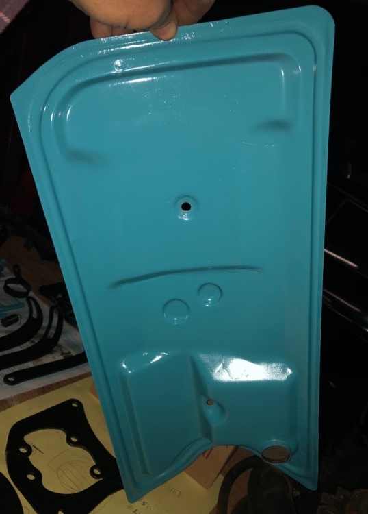

• started cleaning valley pan. It's 2 pieces of stamped steel, spot welded together around the perimeter (22 spot welds). PCV vents into the space between, and it has a few 'drain' ports on the underside. Hardened grease accumulates inside, and it's certainly advisable to clean it out internally as best as possible. Different suggestions out there... or pony up $150 and buy a fresh repro one. Pondering if I can find a tub big enough to soak it for a few weeks.

Got the valley pan cleaned, tried soaking in mineral spirits but that did almost nothing, so I BBQ’d it at around 400-450 for half an hour, cooked the grease inside to dried ash. Cleaned the inside as good as it’s going to get, then slim-coated some JBWeld on some of the deeper pits. Light sand, a few coats of primer, then paint the top side.

Exhaust manifolds got blasted & painted.
Valley pan is painted.

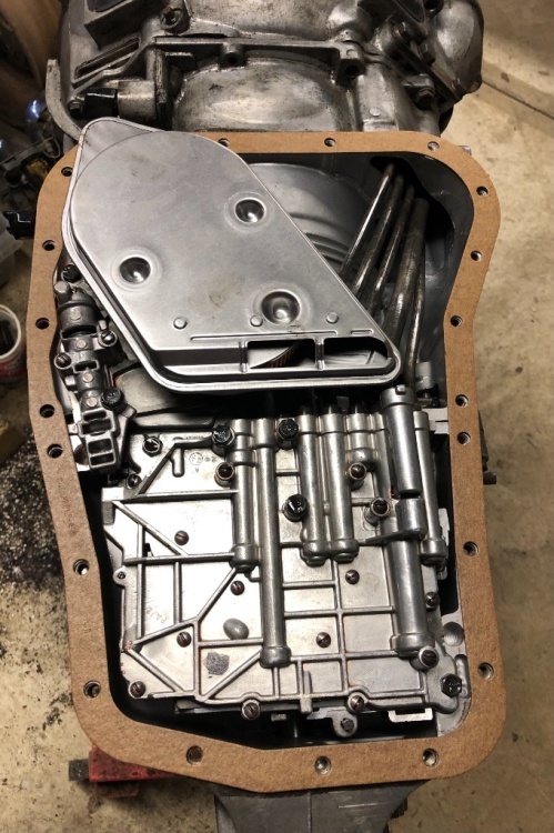

Cleaned the exterior of the transmission off, took off the pan and thoroughly cleaned & primed it. Fluid looked excellent/clean, no metallic particles found in fluid/pan. Have a new filter, gasket and new front/rear seals to go in once pan is painted. Weather for painting slipping away- low 50s for the highs currently, but can always spray in the basement.

Pan & bolts cleaned & painted. New filter, gasket going in:

• Trans is all buttoned up now- new front & rear seals, pan gasket, filter. Exterior cleaned off, linkage gone thru/lubed. It's off to the side, waiting.
