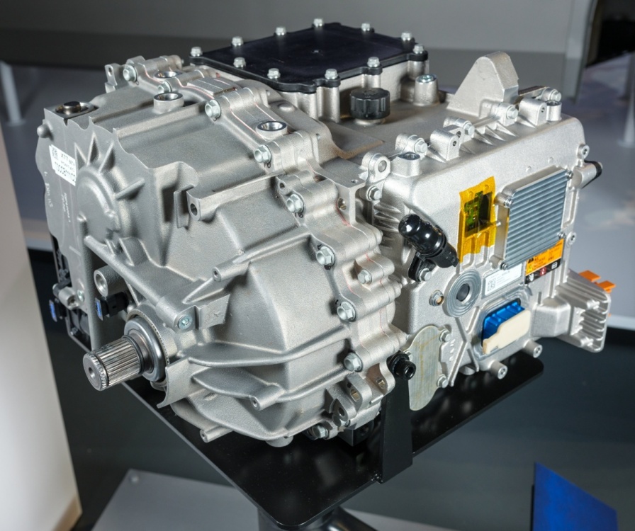

GM's Ultium Drive Unit
The brains behind every Ultium powered auto is this Ultium Drive unit that can work with any combination of Ultium drives. This includes the software of key power electronic components such as the power inverter module, which converts DC voltage from battery to AC voltage to power the motors. To quote GM's press release: The HUMMER EV’s 0-60 mph acceleration in a GM-estimated approximately three seconds – Watts to Freedom mode2 –is largely due to GM’s electric drive software expertise in addition to its key competencies in motor controls, power electronics, motor design and development.
With GM's current EVs, that being the Chevrolet BOLT, BOLT EUV and past electric autos such as the VOLT, the inverter, power electronics, accessory power module, onboard charging module all resided outside in individual units adding to complexity and cost. The Ultium Drive Unit will have all this integrated reducing cost and manufacturing complexity leading to a planned higher reliability.
As some might say, simplicity is the answer to reliability thus GM's move to reduced complexity.
GM's equivalent electric parts of today in an Ultium design will have 50% less mass and volume while giving 25% more capability.

GM is slowly releasing images of their electric motors with transmission system, wow are these compact.
There is a whole new series of pictures on their web site at various stages of creation / R&D. Very cool to look at found here: GM Corporate Newsroom - United States - Images
